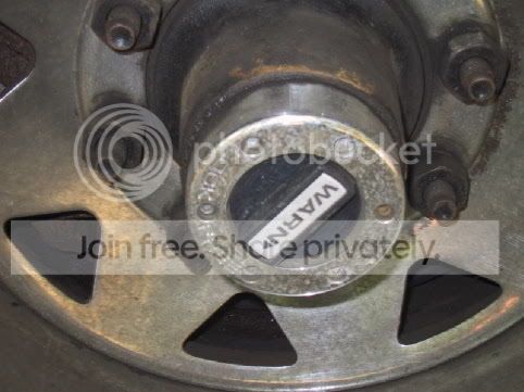

Warn:

Mo Money! I know Warn $185 are good but it looks like I can get Rugged Ridge $167 or Mile Marker $119 a little cheaper.
