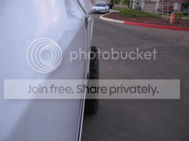

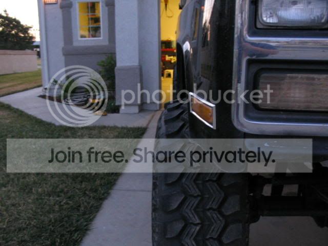

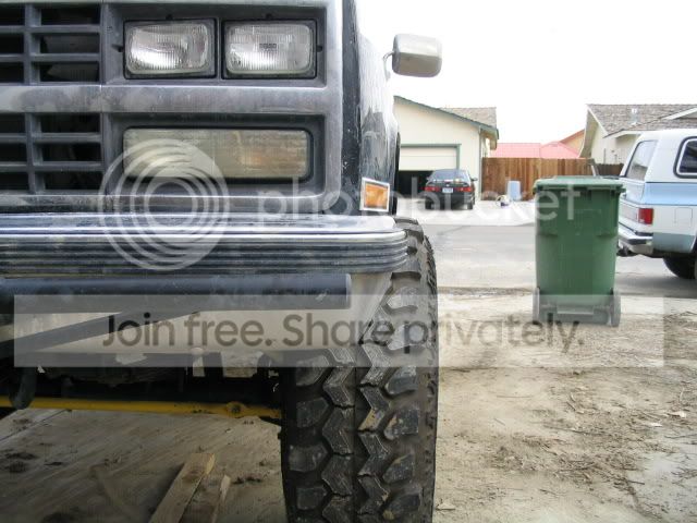

I have the same front axle and used.....15x10 Eaton blackpowder coated wheels...3 3/8 backspacing. A real little bit of caliper grinding with a 4inch grinder and thats it. National has them cheap but they are special order and take a few weeks to get....heres 2 pics of them on my stepside with 39.5 15 15s and the other longbed i sold with 35 12.50s. The last one is a side shot so you can see how far they stick out , 2inches in the front and half inch in the rear with 35/12.5/15 bfg mudds.......

Here are a few pics to help.
These are all 15x10 with 4.25 backspacing and 12.50 wide tires.
These are 12" wide wheels 4.25 backspacing with 14.50 wide tires.
These are 10" wide wheels with 3.75 backspacing and 12.50 tires.
