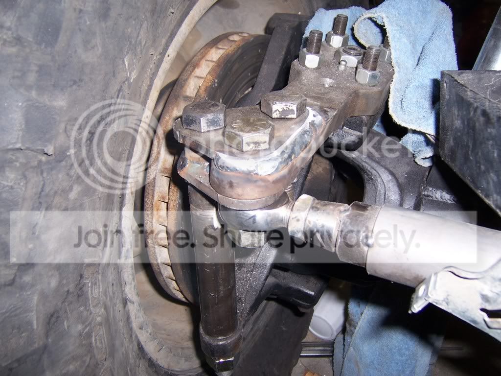

sweet, Im going to get a set when you start selling them. Can you make variations on these? Im wanting to do something like this without me doing all the work (that's where you come in :D )
Id like to put the heim on top in double shear. couple this up with the knuckle gusset kit we discussed today and I think it would be beefy. I'm in no hurry to get this done. Would you be up for the task? I will weld it up if you include all the pieces drilled out.
I could do that. Don't look to complicated. (famous last words.)
any idea on cost? any way to do it and keep using tres? Like machining it all 1 piece?
Not sure i'm following you. What is your main goal here? attaching it to the lower tie rod hole to spread the load? Double shear or....
