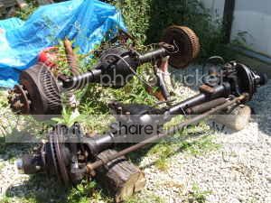

Hi guys. A couple days ago I bought a 14 bolt rear and a D60 Chevy front axle. I bought them for a decent price with the intent to resell them. The front D60 has automatic hubs. The axles supposedly came out of a 1987 1 ton (obviously). Were auto hubs very common?
I do not know the gear ratio. I'm familiar with Fords using tags on the diff covers. I know I can count the pinion rotations to figure out the gear ratio if I have to.
My questions:
1. Were auto hubs very common? Were they only available certain years?
2. Is there a simple way to tell if the 14 bolt has a gov-lok or if it is open without pulling the diff cover?
3. Did GM use any sort of tags for gear ratio's like Ford did?
Thanks for any advice,
Roy

It is a D60, it has kingpins. Here is my ad (only picture I have at the moment): http://columbus.craigslist.org/pts/813576048.html
This picture may show up slightly larger...it is the same one:

This one is actually readable 4:56's (I'm just not a very good photographer)
