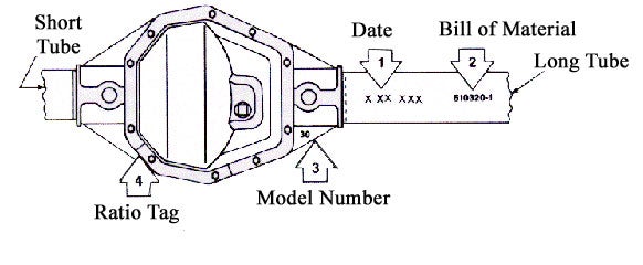

K. I got the guy to read the numbers off the diff cover, off of the front end and the numbers were: C37986. I think. I was kinda muddy and hrd to read but that is what i got.
Can this help to identify whether or not it is a dana 60. I got these numbers over the phone and its a pretty good drive to go back just to find out that its not worth it. So if i could figure this out before i go back that would be great. Any help would be awsome.
I used the D60 bible over on pirate... they link to Dana's site where you can search for a bill of material (BOM) on dana stuff. I put that number in, and it didn't find anything. My guess is, the number is incomplete. Dana didn't stamp it very deeply into the metal, so its a real biaaatch to read and the guy may have left off a couple of digits covered by dirt or something.

The BOM # with be on the axle tube and NOT on the diff cover.
BOM location:
Photo courtesy of BV D60 bible.

What could the number on the diff cover tell me?
not as far as I know. I mis-read your post... I thought he got it off the tube. Its pretty much the only number of use. If I was you I'd make sure the u-bolt/steering arm bolt count was 60-like and then just go out and see the dang thing. If the guy would snap some pics it would help a lot. lol!
