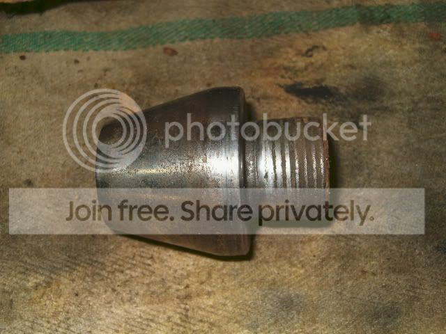

On my way to stock piling the weapons of my build, I have obtained a Chevy 60. My question, I have it torn done to the housing. The knuckles are off how do you tell if the king pins are worn?
There is no deep grooves, pits etc. I did not see any metal shavings in the grease/ plastic bushing.
I have the Ampco (bronze) bushings to go back in, and will be investing in aftermarket knuckles.
TIA

Grooves in them, ideally they would be smooth.
That is how mine are smooth, It looks like this thread lost some info. We did conclude that the king pin rebuild kits from ORD had the king pins correct? I know something was going to be checked today. These are the kits that have the bearings, races, seals etc. it just does not list having the actual pins.

Mine came out easier than melted butter:
