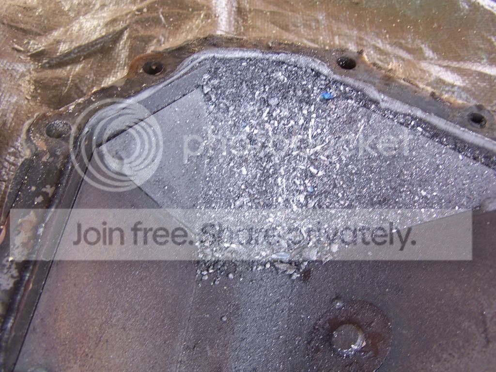

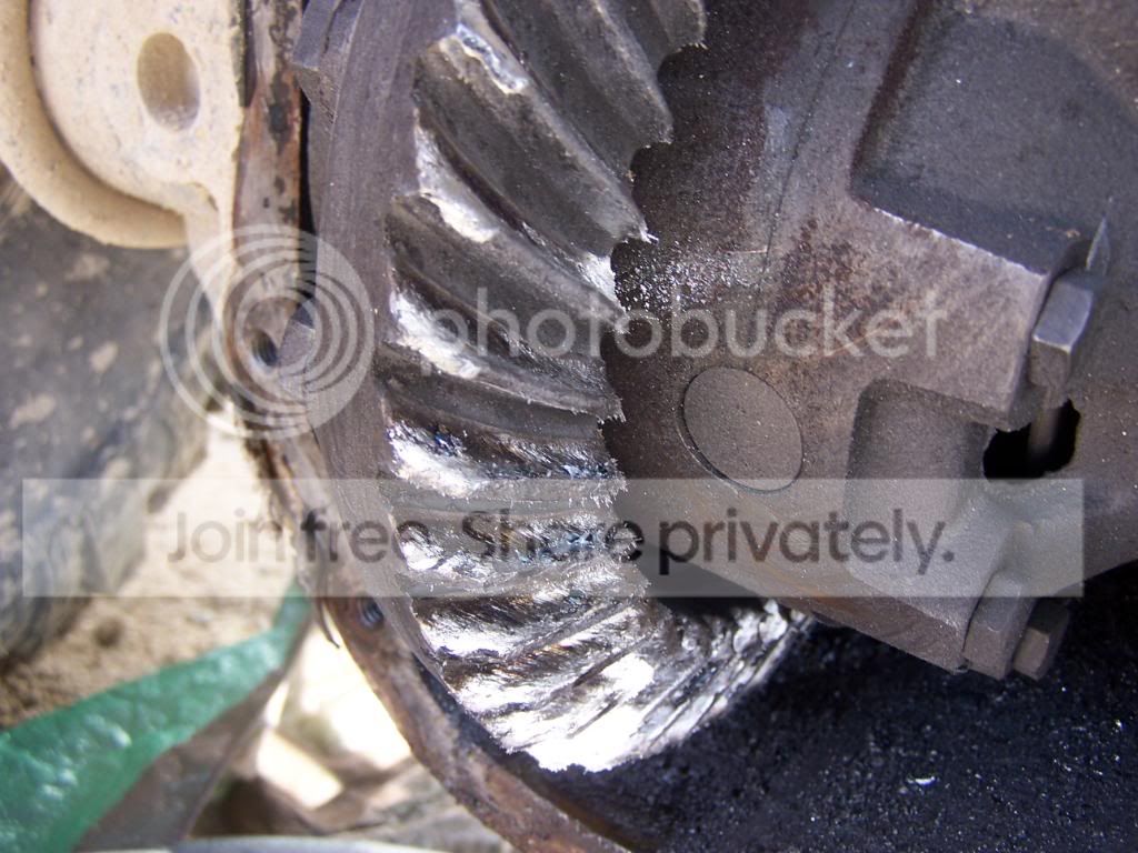

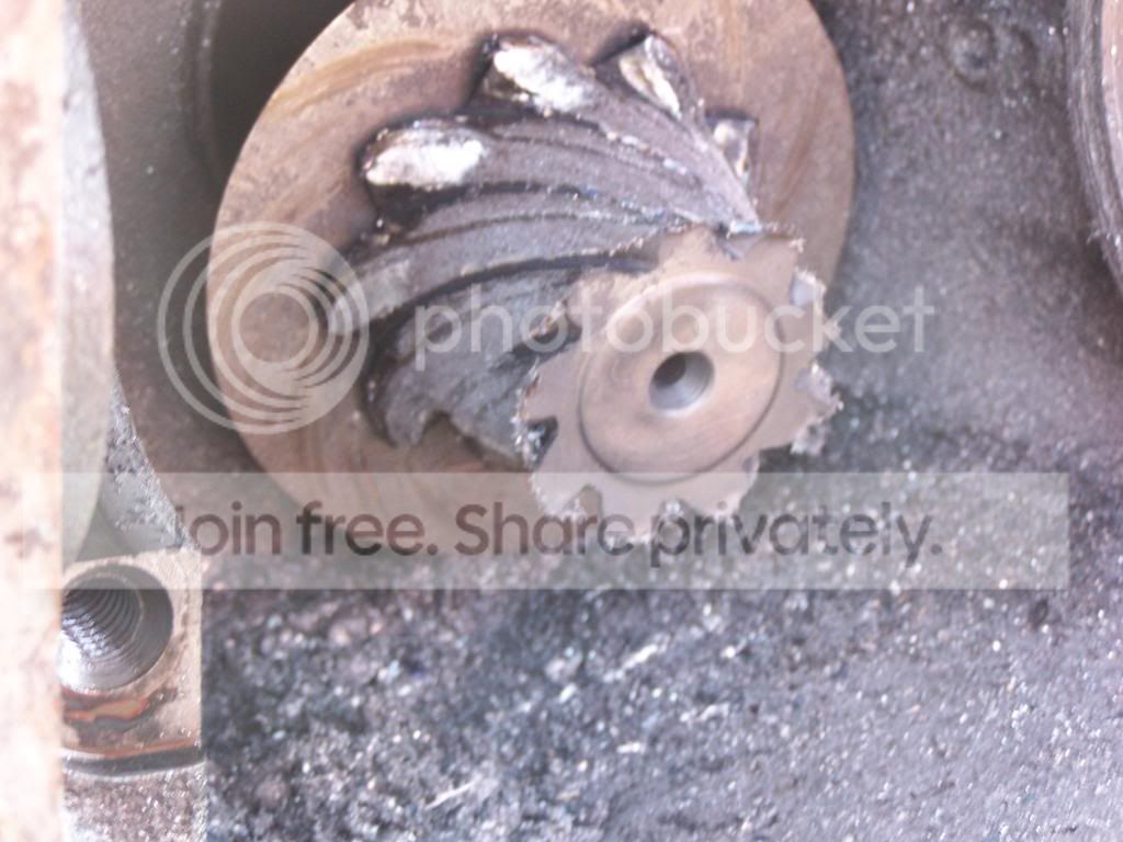

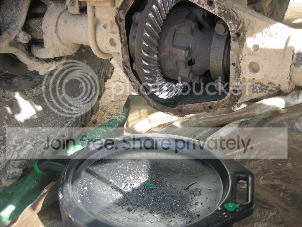

Here's a 60 that ran w/o oil for a looooong time...
Wow! When someone says no oil, I usually think they mean not enough oil. I doesn't look like that ever had any lube.
Funny thing is that happened at the Hammers, the guys did a R&P job out there in the dirt and ran it the rest of the week. Needless to say I was impressed.
