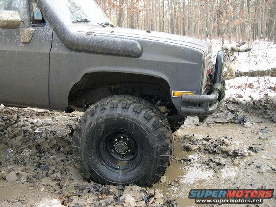

I've got a dodge external D60. I like flanges but they're getting harder to find and I also trailer mine to the trails. I blew a few of those full turn hubs. I liked them but they didn't like me. So $550 later and some 35spline outers, spicer joints and these flanges I'm rolling gracefully again. I've got a welded front which does bring the suck on the hwy so I have to remove one flange for payment traveling. I gave them hell at tellico and they did awesome.
Here is a picture with one removed and yes thats duct tape.
