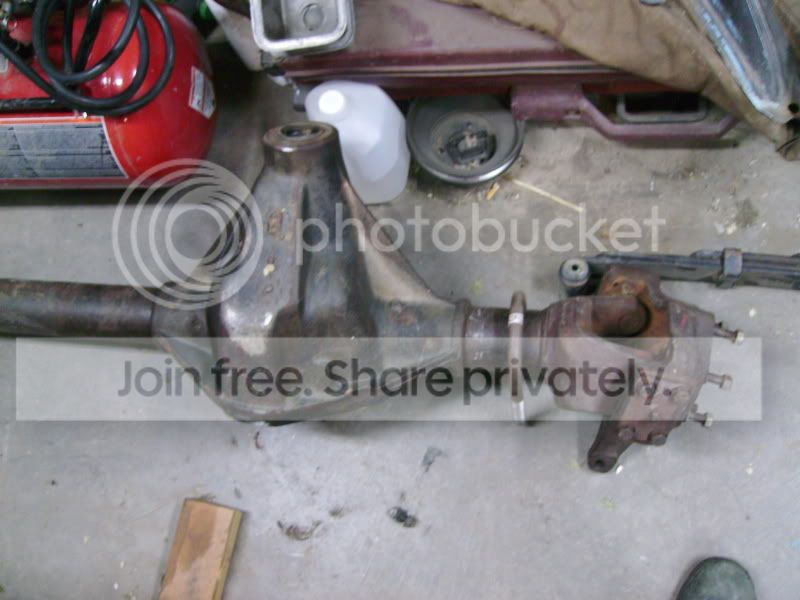

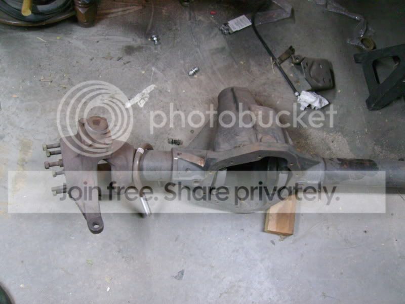

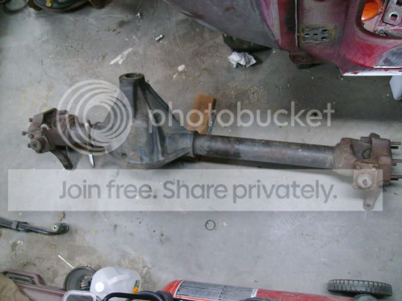

Im trying to figure out how to rebuild the D70 I have as cheaply as i can. I have the housing, inner shafts, pinion, 2 carriers one lincoln locked the other open and the pumpkin cover. I dont have any of the outer knuckles or stub shafts, brakes or rotors. The open carrier has 7.17 gears in it the locked one im unsure of. I wont be using that high of a ratio btw.
EDIT: it is an open knuckle housing supposedly out of a ditch witch, passenger side drop.

I've seen a few of these Ditch Witch's with these steerable axles. They definitely are D70's with open knuckles BUT..... are they the same width as the standard front axles on full size trucks?
Something to think about there.
This one fits pretty close, I haven't actually been able to mount it yet but it looks real close to being a good tight fit.

i'd start out by measuring that thing, to me, from comparing other pics of a 60, this 70 just doesn't look as wide, especially the short side.
Yep, exactly what I said above.
