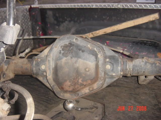

ive got a guy wanting to trade me a dana 70 with the b cast into the housing for the dana 60 rear axle out of my truck. The dana 70 has 4.10 gears, a trac-loc, and good drum brakes. My dana 60 has 4.10 gears, a power-loc, and brand new disc brakes.
Also i have been told that the dana 70 b has a limited gear selection, what gears would i be able to run? Wanting to run either 4.88's or 5.13's.
Thanks
