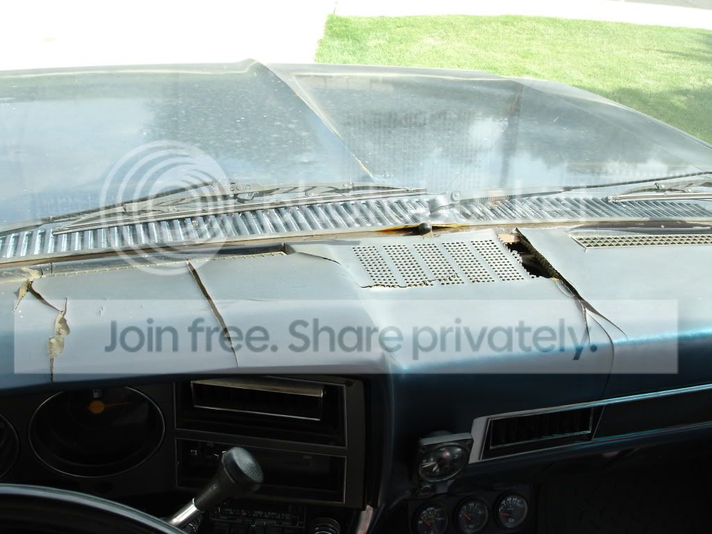

the red one is AMAZING. too bad its red....
that is the one i am going to have to paint.

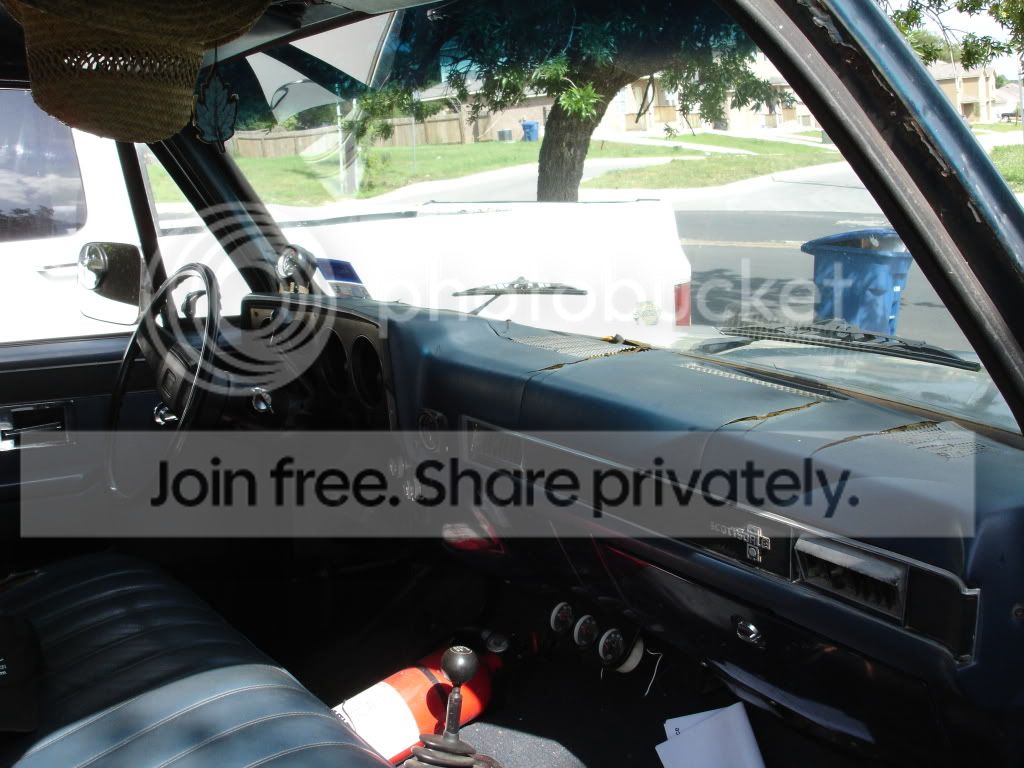

this is what i have to replace
