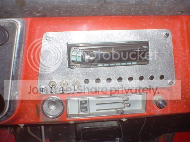

Kert at diy4x cut me this. It will sit a touch higher than it is hanging in this pic.
toggle switches. fuel pump, elec fan, tranny fan, kc lights, rock lights, winch on/off, winch in/out, etc.....

Simply mounts by screws through the sheet metal?
Looks good, I need to do something like that too, P/O hacked the hella outta my dash.
I will cut a big square hole in the dash then drill the 4 1/4 inch mounting holes and use some those speed nuts to holed it to dash then you can drop the whole panel to do any wiring work and it also moved the CD player up and eliminated the ash tray

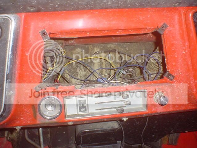

You got me thinking about how freakin ugly my dash was, so I followed your lead and did one for myself.
Not finished, still need to wire it all back in and mount it but this is one days work.
looks good, got a pic of the folded over part underneath?

<hijack> What's the red arrow thingy used for? I've seen them before in build pics. <\hijack>
teh red arrow deal is a magnet for holding things while fabricating/welding.
Looks good Kurt. I was wondering if you were gonna take MNorby's lead when you asked on the other forum.
Correct, only quick way I had of holding it in place for the pics, now it's duct tape holding it in. :rolleyes:
