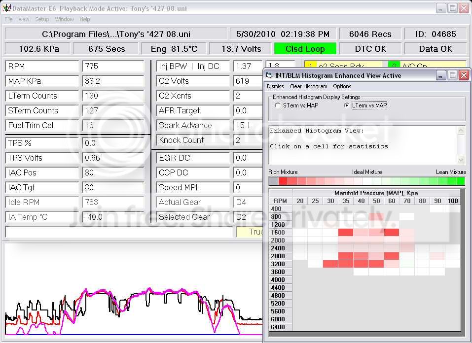

Maybe other CK5 members can assist with ideas why the data logs show the engine running rich? The DataMaster Histogram is an excellent tool to "See" if the engine is running rich / lean!
dave w
Bump. The above pic's from dave are of my log. Anyone have a reason it's running so rich? Return line is not clogged as I had hoped. my 91 has headers, tbi spacer, heated o2, K&N filter. I've also rebuilt the TB hoping to fix the problem and had no luck. Good spray pattern from the injectors. Could really use some CK5 help.
