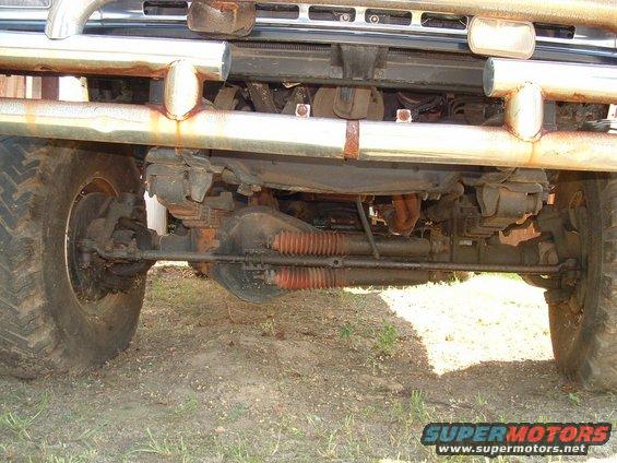

I do not know who makes it but this is what it looks like...

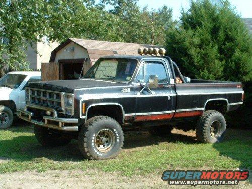

also my $500 score truck...
what I kept
d60 front
dual tanks wiring and floats
factory tach
new 4 core rad
alt
carb
rollbar and lights
then sold the 14bff and my d44 with 4.56's for $250... so all that really cost me $250!!!!!
oh yeah there is a 396bb in the bed... I gave the remains of the truck to my bud.. he got a divorce and had to get rid of the truck...
