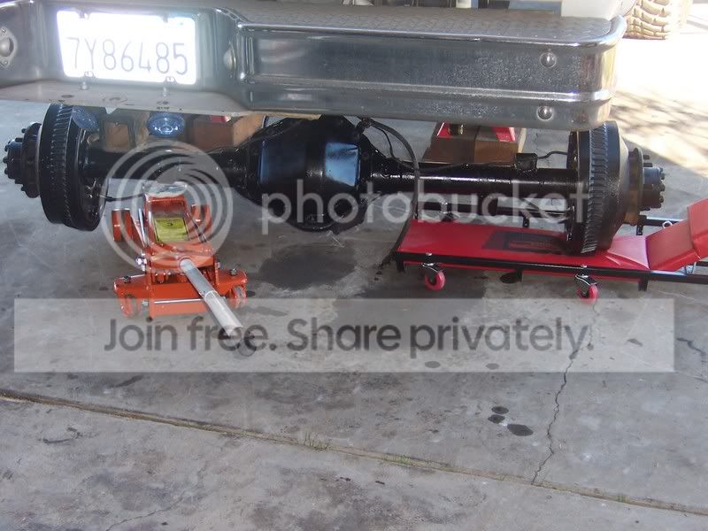

Ouch! I used a cherry picker a floor jack and creeper (yeah I know but w/e it worked) to slide my 14ff under my truck by myself but I definately could of used a hand...
Smart way to do it. My problem is the gravel driveway. Good work though!
I have bad memories of discovering, at 10PM, that the truck needed to move into the garage about 6" for the door to roll down -- and the front axle was still off. :doah: Half an hour of nearly killing myself resulted in some adventures with a four foot crowbar and furniture dollies... but the truck got in :deal:

Hope you heal up and the friends show up to help. Look forward to seeing some more pics of the progress. Are you finding it easy to do other than the lack of help? Curious because I might be swapping axles shortly and have never done it either.
Well, if you have lots of time, you could take the brakes and axle shafts out. You’ll be amazed how much lighter an axle is after you have taken that stuff off. (Re)install the axle housing and put the brakes on later. I have done it both ways, but if I’m doing an axle swap by myself, I’ll strip the axles. Now my nephew is old enough to help me if I give him a call.
So far it's been pretty much bolt in. The emergency brake lines are a little different but not insurmountable. Figuring out the angles for the drive shaft is going to be trial and error. I'm going from a 465/205 to a 700r4/208. I have about 6 diff. shafts and none are the right length. I will probably just swap in the whole drive train to make it work with what I have. I do plan on moving the front axle forward either 1" or 1 1/2" with ORD's zero rate. I hope the front shaft is still long enough. Thanks for the concern of my health. Hope I get the right pics up showing how it all goes. Time for bed now, Good Night Moon!:D
Good idea on disassembly! I will have to read up on that. I've never done it myself, and the axles (whole truck) sat for a few years in a field. The brakes etc. could probably use a going over. They were brand new when it was parked, so maybe just turning the rotors and drums will be enough. Don't know yet. Take care!
Another tip I could give for the front is to put the pumpkin on the floor-jack. Jack the housing up till the passenger’s side reaches the spring. The passenger’s side is going to go up first because of the long side is causing it to be off balance. That is okay. Try to line up the spring pin to the hole in the housing by moving the jack. Once you get the housing lined up to that spring pin; jack the housing up. The driver’s side will swing up. Aline the other spring pin. If the pin is off side to side; put a little upward pressure with the jack and hit the side of the spring with a dead-blow. It should go in. The housing is probably going to be tilted back and not lined up straight with the spring pins. Don't fret. Put the u-bolts on and tighten the u-bolts till the slack is gone. Drop the jack and reposition the jack toward the yoke and jack up till the spring pads are parallel to the springs. Tighten the u-bolts.
Two problems with your current back problem is to get the housing on the floor-jack and the gravel driveway. The gravel driveway can be solved with a piece of plywood, but you got to man handle that also.

To JDNobodi, that's kinda how I got the 14ff positioned. Yeah, the gravel driveway makes it tough. WHat I did was roll the axle over with the tires still installed, then took the one tire off, swiveled the tired side under the truck, then the plan was to skooch the end without the tire under the other side, but the axle fell off the jack.:yikes: That sucked. Lifting it back on is what probably screwed my back up. It wasn't till the next morning that the pain started.
