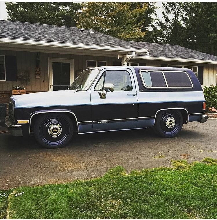

OK, I did a little more digging and will derail this thread just one more time.
These are 18s, not bad.

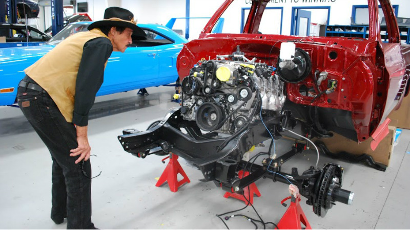

Richard Petty has 18s on his K5 also

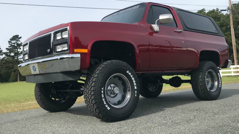

These 20s are a bit much for my taste
Ew. The center caps are way too small for the diameter of the wheel and the lack of dish makes them stick out like a sore thumb.

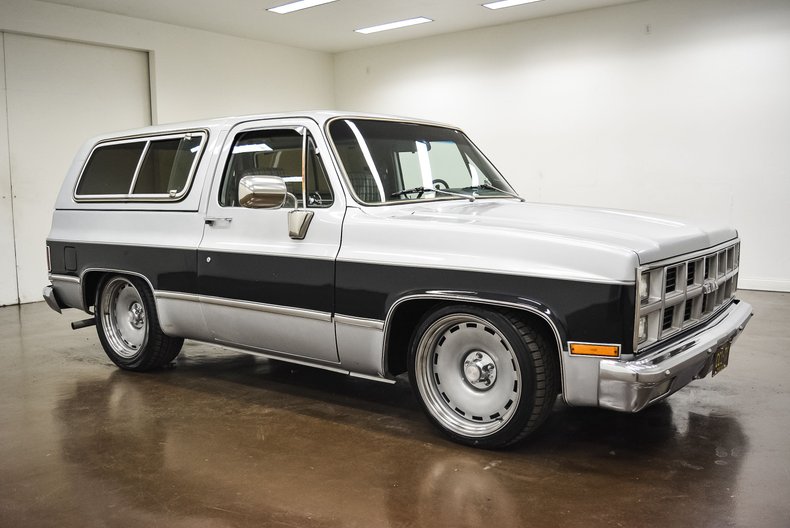

Not my favorite, but passable. Might be 20s and/or 22s
Much better.
Also perfect.
