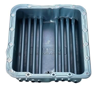

My Dad used to have a Dodge motor home with a torqueflight tranny that had an extra deep pan. What was diffrent was the fact that it had about 5-6 1" diameter tubes through it for cooling. I have never seen another one like it......
You mean like this

muddermilitia said:
Yea I know I've got one
Are the tubes on yours also plugged up with grit & junk? Everyone I've seen on a truck for any period was like that.
I don't like the tube gig.. More failure points... Not to mention they're steel and aluminum is a eleventy billion times better...
No they're not. But that could be because its on a trans I rebuilt in school a year ago and has not been installed in anything yet:doah:
FWIW, I have the tubed Derale pan on my Sub. Pressure washer does wonders for keeping the tubes cleaned out.
