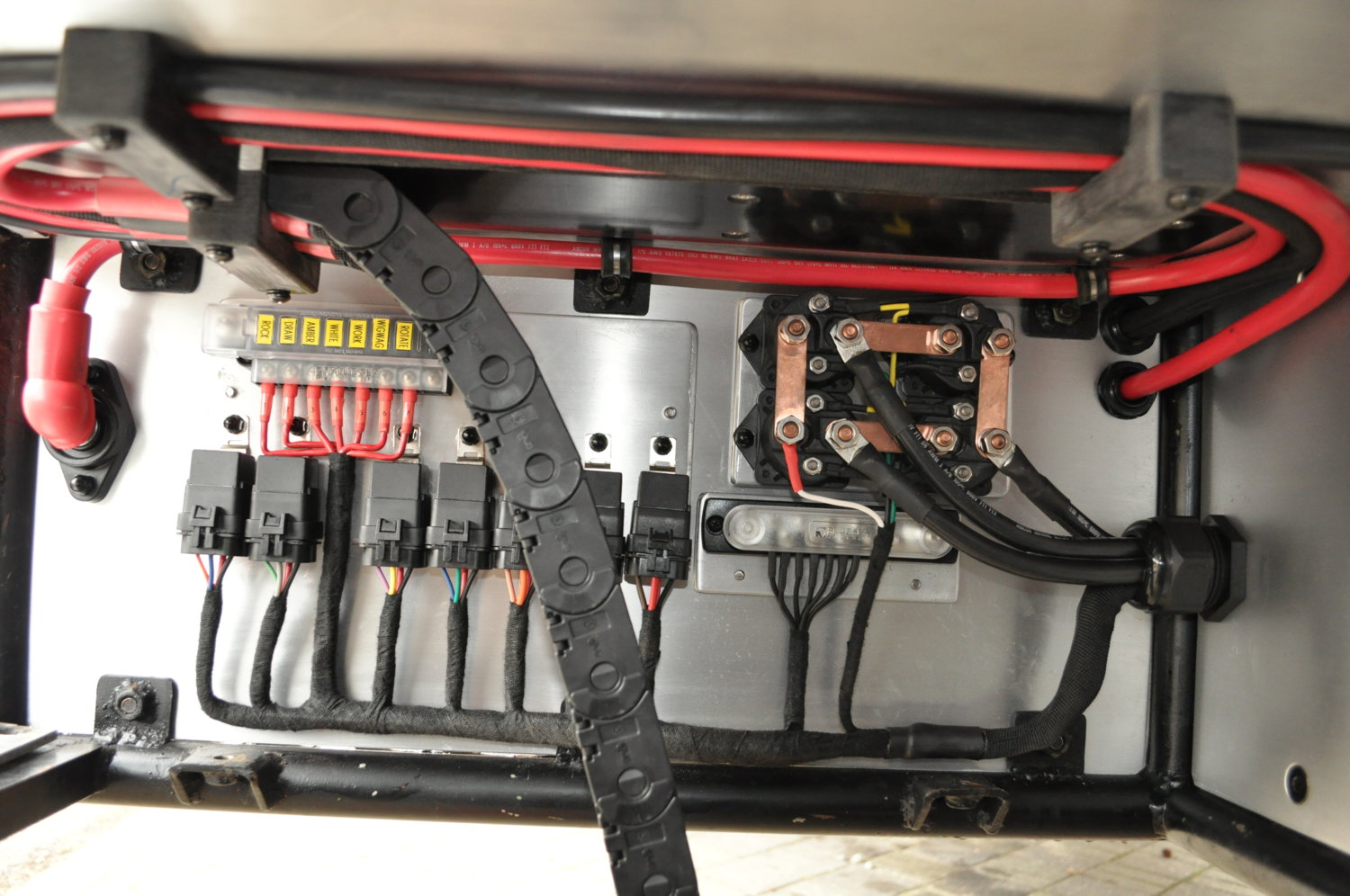

i run delrin as both, wear-pads for my cable carrier, and hold down blocks for my cables...
