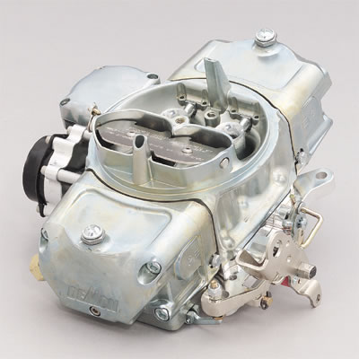

I am just wanting to know if they are any good? Has anyone used them if so what carburetor did you use. Thank you for your time. /forums/images/graemlins/ears.gif /forums/images/graemlins/ears.gif /forums/images/graemlins/dunno.gif I am thinking about this one. Carb

[/ QUOTE ]What about this one for a 400 cid sbc. ???

oh I get it now I read it wrong. sorry. that looks like that would be a good for a sb 400, but hey what do I know I am the one that started this post. /forums/images/graemlins/rotfl.gif
Re: Demon Carburetors? Good or Bad?
I hear ya. I'm not the most knoligable when it comes to cfm. I ran a 600cfm Holley on the hot rod with a built 383 stroker, but not sure on the needs of a mostly stock 400. I would think 625cfm would be close.

well I have it installed (Thursday night) and I made a 300 mile round trip with it yesterday and it ran great. This carb is so simple that event I can tune it. It came with a nice Tuning video and every thing worked great. /forums/images/graemlins/thumb.gif
