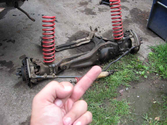

The Dana 44 IFS on my '89 Ford
Not real IFS. It's a broken solid axle that changes camber as the suspension travels. Designed by tire companies to increase sales.
True, I was thinking about that as I was typing. A true Independent would be like the axle on my M-Class.
The chunk housing is bolted to the frame, and both axles pivot at each end.
But, you have got to call what my truck has something, its not solid, and the two axles can move independently, so.....
Plus, I think even Dana calls it an IFS to differentiate it from a solid.
Maybe we need a third term. Like a semifloater, this could be a semiIFS......
Oh, we can come up with a few terms for it... :D
