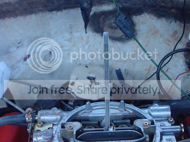

Did I stab the dizzy right?

This is FOR SURE on the compression stroke, the piston is at the top of the cylinder, and the timing mark is on TDC... I haven't touched it since it was running like Craaaaap... I think the distributor is in right, don't you?

readymix said:
Looks good
then I'm screwed.. I was hoping I was a tooth off... I guess I will go try a different set of plug wires and cap and see if I can mess around with it some more.. I just don't understand why it won't run right... There must be something I'm overlooking
Yes that is in the right position, so what is the problem? How is it running, besides bad?
the pic may be a bit decieving by the angle of it... the rotor is actually pointing more toard the center of the manifold than it is #1.. ?
That is the correct position. Best way to double check is look at the firing order, that is right where your #1 plug wire sits. You do have all your plug wires in the right order, right? The reason I ask is because I changed plugs this weekend and crossed mine.
I think it may need to be moved one tooth counter clockwise, and start the number one plug wire there. It is very important that it is in the TDC compression stroke, and not TDC exhaust stroke.

Yes, I was thinking it might need to go a tooth counter clockwise, the pic doesn't do it justice, its pointing more toward the center of the manifold.
If the marks are lined up then you should be at TDC compression stroke. Unless something is way jacked up. I just went through your same problem about a month ago because we didn't mark my buddies dizzy when we replaced his engine. We were shooting in the dark to see if we could get it. Turns out we were a tooth off, and in the same position 1-Ton has asked you to go (one tooth counter-clockwise from where you are). When your rotor is facing just a bit towards the drivers side from center, that is the right tooth.

Yeah, I think you need to move a tooth or two counterclockwise!
If you need to, you can simply use a big long screwdriver to turn the oil pump shaft, or if you are careful, you can bump it one tooth over at a time until it is where you want it :)
Hey just a thought, did you ever figure out what was up with your #1 plug wire? Is it a new cap? If not check the bottom side, if everything is sparking except #1, maybe you cap and rotor are not making contact, is the cap on all the way? Just trying to go back to the basics, it sounds like a simple problem. But a big pain in the a$$.
I just cleaned off my old plugs and put them back in. Left the dizzy where it was , but turned it ALOT clockwise (enough to achive the some thing as talking out the dizzy and re stabbing it CC a tooth over) , enough that the rotor was pointing to a wee bit before the #1 plug post... I'm about to go turn the key and pray nothing blows up.. I really get scared everytime before I crank my truck...
So if the rotor were pointing stragith down the manifold with maybe I slight slant toward #1, that could be a tooth off, correct? I''m about to go try to fire her up. Wish me luck.

after adjusting it the dizzy to compensate for if it had been 1 tooth off, it wouldnt even crank.. twisted it back in spec and got it to run at 12* BTDC.. the timing is right for sure.. it still smokes black, idles rough, and makes some really loud popping noise out the exhaust under heavy throttle/load... I don't know if its full fledged backfiring, or just a little bit of fuel in the exhaust that is unburned... heck, there was some raw gas that was black colored in the exhaust pipe... shoots out poofs of black smoke..
