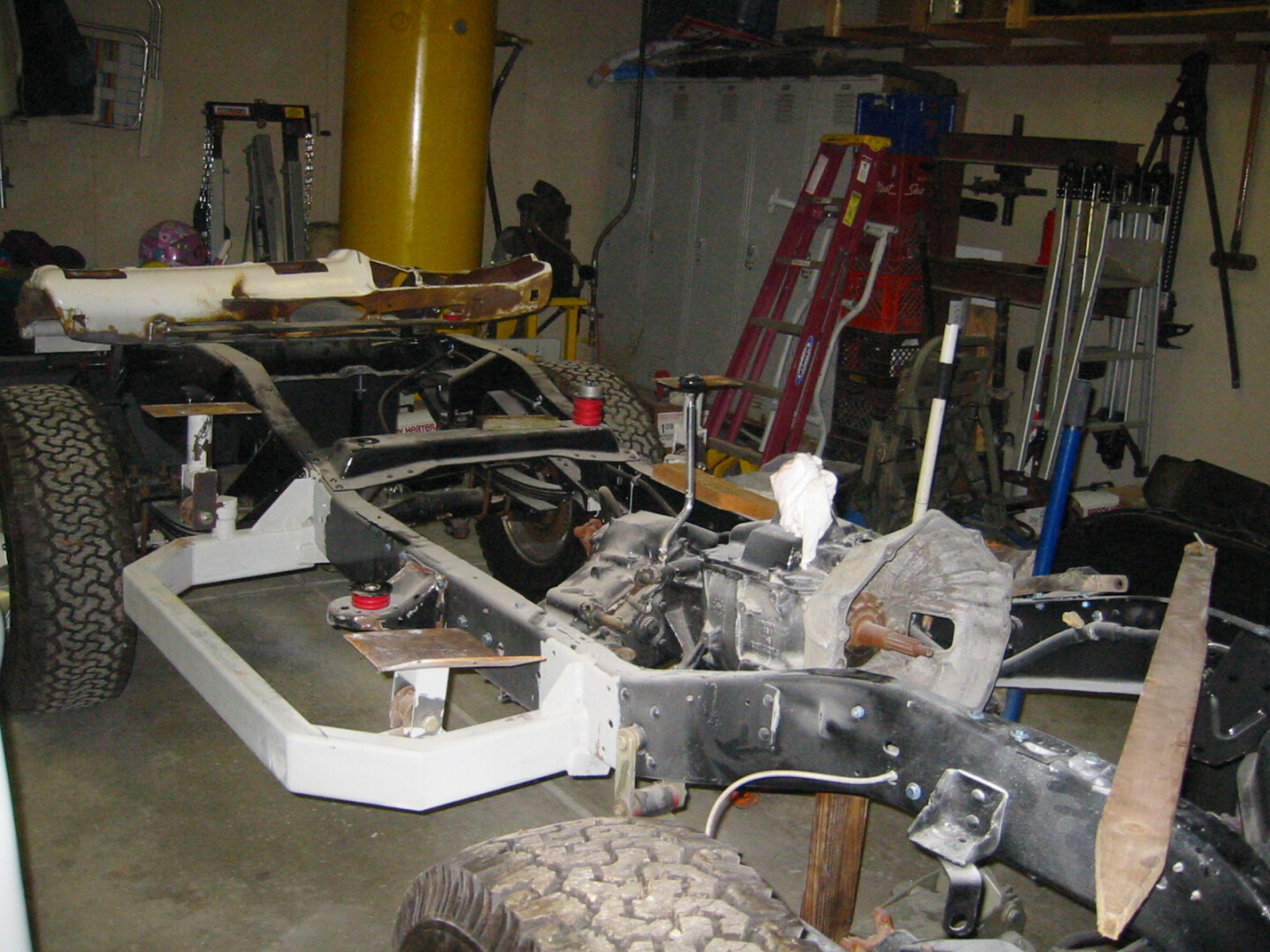

That's what I did. I ran a piece of rubber heater hose down the frame rail and tee'd in the diffs and trans and t-case, then there is a tee in the motor compartment which, when I get around to finishing the truck, I will run up the firewall to someplace as high as I can and put a little filter on it.
If you look closely at the drivers side frame rail, you'll see the rubber line (gates) with the gates tee's (big one with tape on it just in front of trans), and a line going to each of the diffs and trans/t-case (can't really see those though)
Different subject but those "rails" are awesome.
Thank you sir!:bow:
