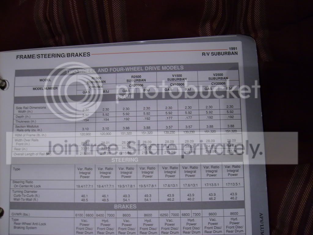

i'll bring my calipers home on Friday and mic the frame on my one ton...in the meantime check this out. Pertains to 1/2 ton and 3/4 ton Suburbans in 2WD and 4WD.
The thinnest is the 2WD half ton at .151" (which is what my K5 frame mic's at) The thickest is the 3/4 ton 4Wd frame at .192".
I'm gonna guess the one ton frame is at least .192" if not a bit more.
