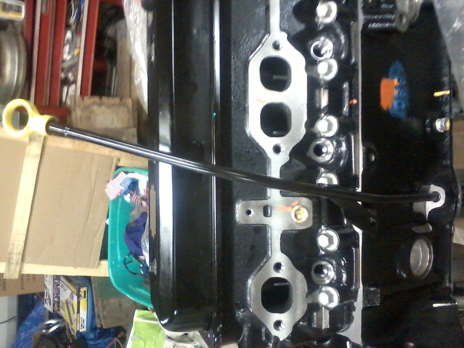

I marked that as a truck dipstick. It came off a 1990s truck. Mid-late 90's, C/K. I purchased some online, they were wrong. Got this one from the wrecking yard for like $5.
I believe vans of that era had even longer ones that push it up to near the core support.
Car dipstick on same engine

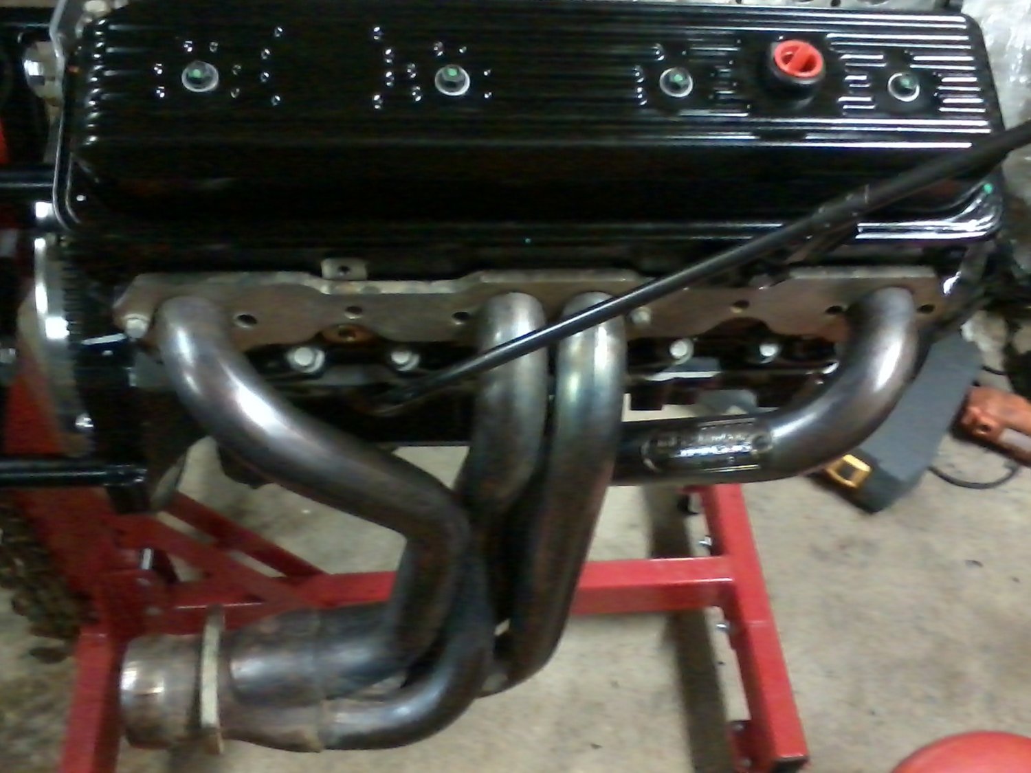

You are welcome. Not sure if you'd find them searching dipstick or not, but I recall at least one thread on them. I'll see if I can find it. Not a great pic but here's the same dipstick with headers:

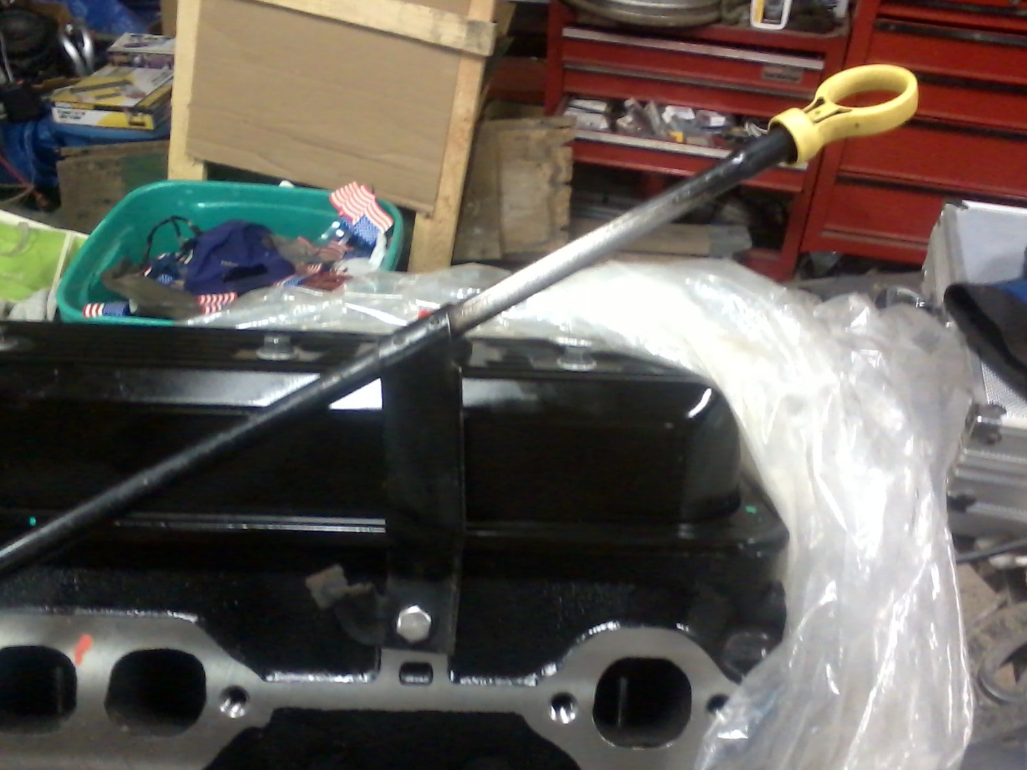

That seems to fit fine. I'll snap a pic of mine, the tubes are bent differently. Well, it's difficult to see, but I'm going to search for a 90's era trk dipstick, and maybe a van.

Based on your pic, it looks like mine would probably fit IF it hugged the block a bit more? I want to say I've seen someone that broke the bottom of the dipstick off, so it seems some might be a bit brittle to bend. But if you tried to bend it up above the header tube, perhaps there is enough distance that it wouldn't put all the stress on one spot.
