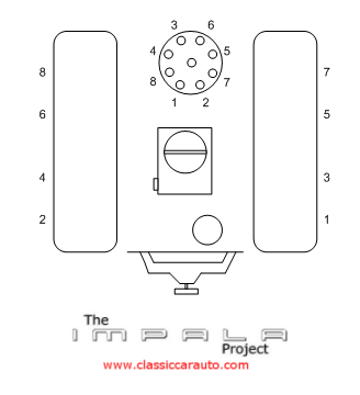

Ok so when we took of my distributer we didnt lable #1, soooooooo now we dont know where any of the plugs go. Can anyone help me time my engine. My distributer is the ac delco or delco remy. The stock ones i belive.

I'm guessing you've got a V-8? If you've got HEI I believe you need to rotate the numbers on the distributor one spot counterclockwise.

LOL. Been there, done that, but not for a long time. Even your el-cheapo Chilton's or Hayne have the firing order. :shame: for not having the book.
In this regard it's no matter who makes the dizzy, just how many cylinders.
The picture posted says it all.
-- A
Turn the engine over until the timing mark is on the tab. Lift off the dizzy cap and the rotor will be pointing at either the #1 terminal (toward the front of the engine) or the #6 terminal (toward the firewall). Start there and work through the firing order. Twist dizzy back and forth until it runs nice and sounds good :D
