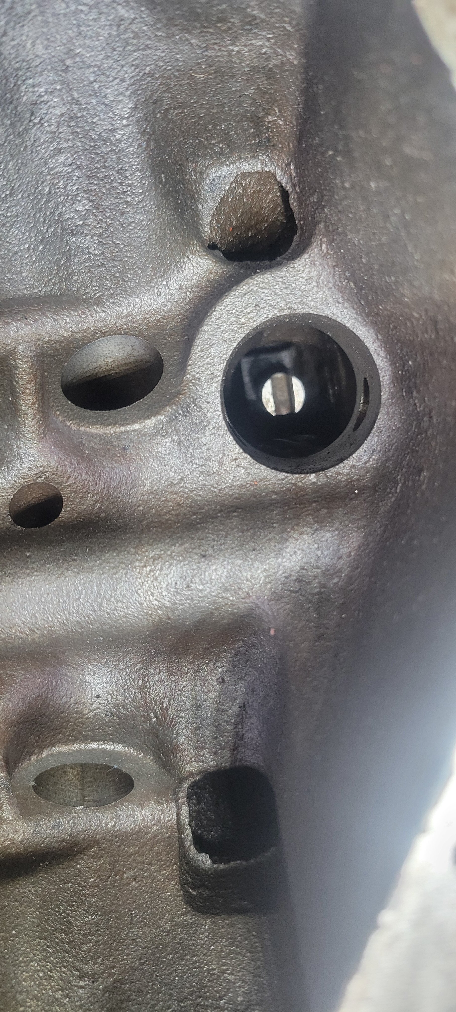

Hi gang, the weather looking nice lately so I'm back at my 400 SBC install w/ a Sniper Efi and I've run into a snag. I bought a Holley Sniper kit from Speedway Motors (#9100797) and I've found that the distributor doesn't fit into the oil pump. The gears match up but the slot of the distributor appears larger than the oil pump drop-in. Is there a way to swap out the end of the distributor for a smaller slot?
Dist. Tip
Oil Pump

Hey Wes, looking down the hole it appears that the oil pump slot is smaller than the distributor wedge. I tried putting a long flathead down there to rotate it to match TDC on the dizzy but I had no luck. If you look at the photos in the link it appears to be very small down in there or my eyes are playing tricks on me.
I did look at photo, to hard to tell, do you still have the dist that was in the engine before ? I am assuming it had one, I would compare the old with the new.

Need a better picture of the oil pump
Something you could do is drive the roll pin out and remove the gear from the end of the distributor. Not only does that remove interference from the camshaft, but also separates whether it's the diameter or the slot width that's limiting you. If it's the slot, you have the option at that point to grind it narrower or swap the shaft (or whole distributor) out. You could also pin the gear to something else, like some tubing, to verify if the diameter is compatible.
The harder way is to drop the pan and pull the pump and shaft out to look at the fit on the bench. The upside is now you can swap anything and confirm a match before reassembly.
