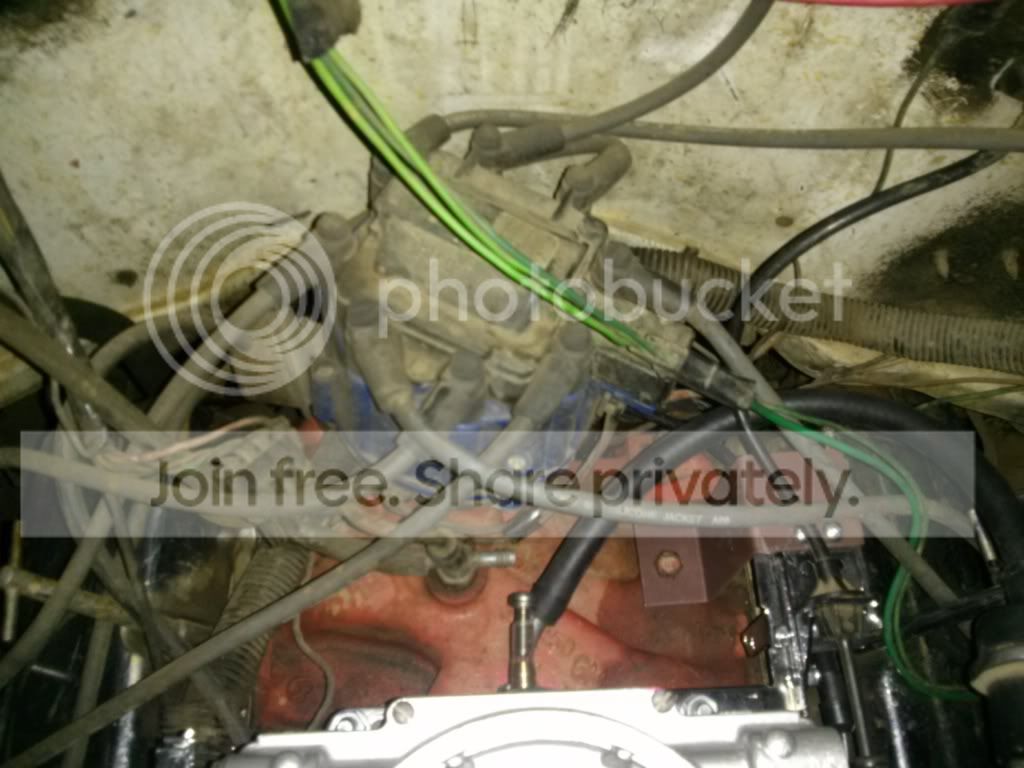

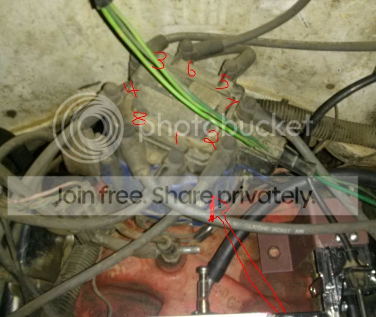

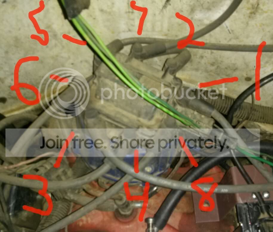

Okay so... my timing is a bit off. Gotta be. Rough idle, kinda hard to start when cold. I just unstalled an edelbrock 1405, and havent hooked up the choke YET. Though, 55f isnt THAT cold. Anyways... heres what i got. Obvipusly they stabbed the distributor wrong. The wore going to 1 it at like 3:30 (clock position) pretty sure the order is correct but....
Nevermind the manifold vacuum leak, the cruise control is removed, and that is plugged now.

Then pop the distributor cap off and make sure the rotor is pointing at or just ever so slightly past where your number one plug wire is.
Then make sure they're wired 1-8-4-3-6-5-7-2

Yes he's off slightly clockwise from the traditional position but like you said it can still work if wired correctly and the rotor is stabbed in the correct orientation for the "off" cap position.

The firing order is correct. I need to get a timing light and verify it all. I blindly turned the dostributor counter-clockwise, (slightly advancing the ignition timing??) And the idle speed increased, and seemed smoother. This was with a cool engine, and i noticed when up to operating temp, it idles like poo
your retarted!! lol not you the timing, I would rotate it counter clock wise so your number one plug as indicated is in line with the arrow I drew in. that should put you in the 10* advanced range about.

DANG!!! yep it got stabbed way off and was rewired to make it work.
