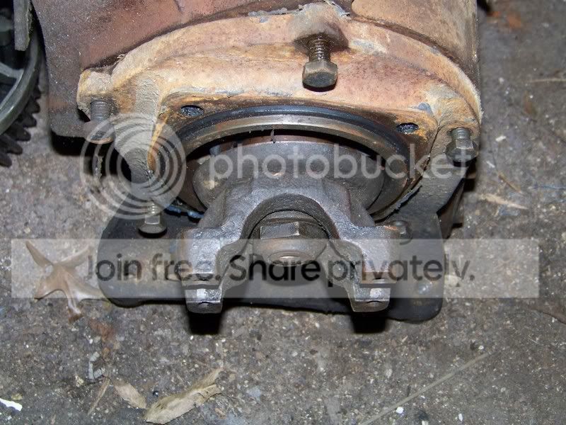

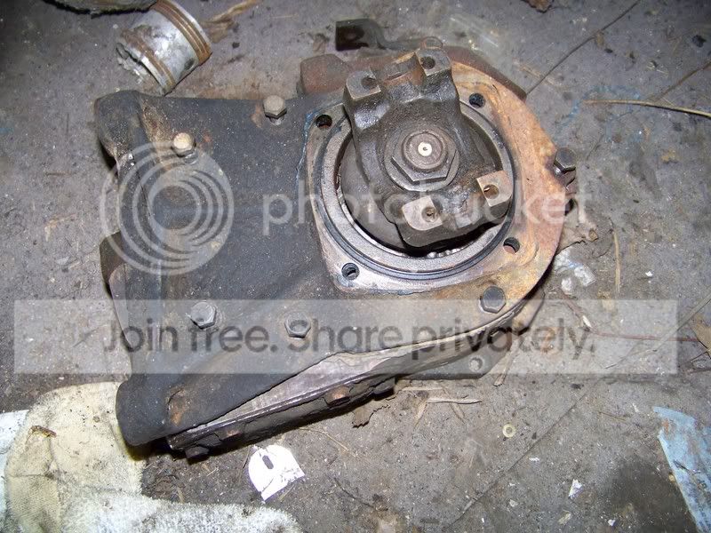

Here is a pic of the ford input in a gm203. I got all the info on how to do this from ord
and i used the adapter on it for extra mounting support
Is that an open bearing I see behind the yoke ??
or is the input shaft sealed to the case and the yoke is just sticking thru the adapter ???
EDIT: never mind....I figured it out.... Is that a t-350 plate bolted to the front of the range box ?
he said its a reg gm203 married tcase with the divorced input swaped in. and 203 units had there own bolt on aluminum seal housing. so its good to go like that. and yes th350 adaptor bolted to it.
