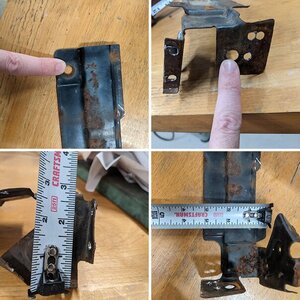

Hello. I'm building a 75 Blazer and I don't have original doors to use as a template for me to cut up some truck doors for my full removable top Blazer. Does anyone have measurements or a template I can use please inorder for me to do this correctly. I know I need to weld in some brackets to strengthen the doors but everything I see online says to look at your old doors to know where to cut. So if anyone can help me, it your be greatly appreciated.
I still have one of my old 73 doors in my shop. I can take pics with a tape measure if you think that would help.

Here’s some pictures I took of some old doors I have. And here’s also the pc in the rear side of the door that I removed that I need in my door
B34A5D21-D086-401F-91A7-C45960C05A01.jpegBAAE828D-66D9-4A1C-88BE-5FDCE7CB4DA5.jpegD9BAC6E7-4B8C-4DAB-AE23-C091539F6866.jpeg420F272F-0118-4939-95BD-5FE4D46C175E.jpegF7219D9A-D801-4E08-B64F-44C59A6610A6.jpeg093AAE20-8077-45CA-B2F3-4F6722C167BE.jpeg

Can you please email the pictures to me because this website wants me to pay the membership just to see the pictures.... my email is [email protected]
Check this album, there’s a bunch of pics with measurements. They’re not mine, just a bunch that I’ve saved over the years.
Your a life saver!!!! Or k5 saver!! Same thing.... thank you!!!
