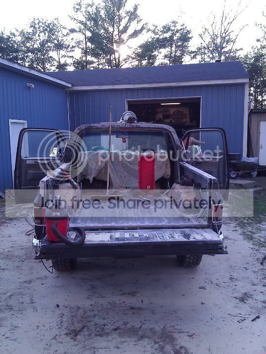

Stripped interior
320 lbs of sandblasting later I patched and prepped.
