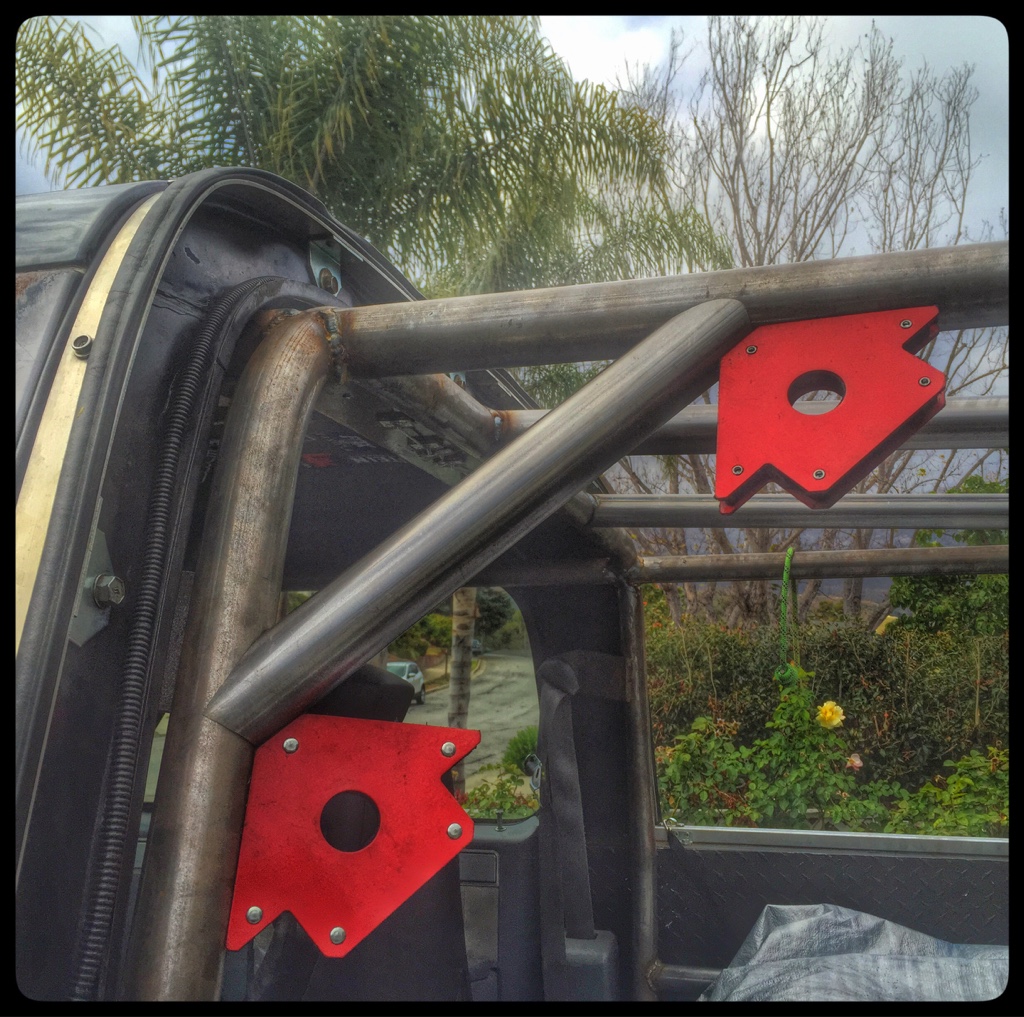

The fit is superb. I literally lay the halo on my garage floor, burned in the rosette welds and seams and it fit like a glove. No massaging, or monkey humping needed. The same for the b pillar. Burn it in, use a ratchet strap to get it where you want it and tack in the seat brackets. They really really produce a solid fixation point for the cage.

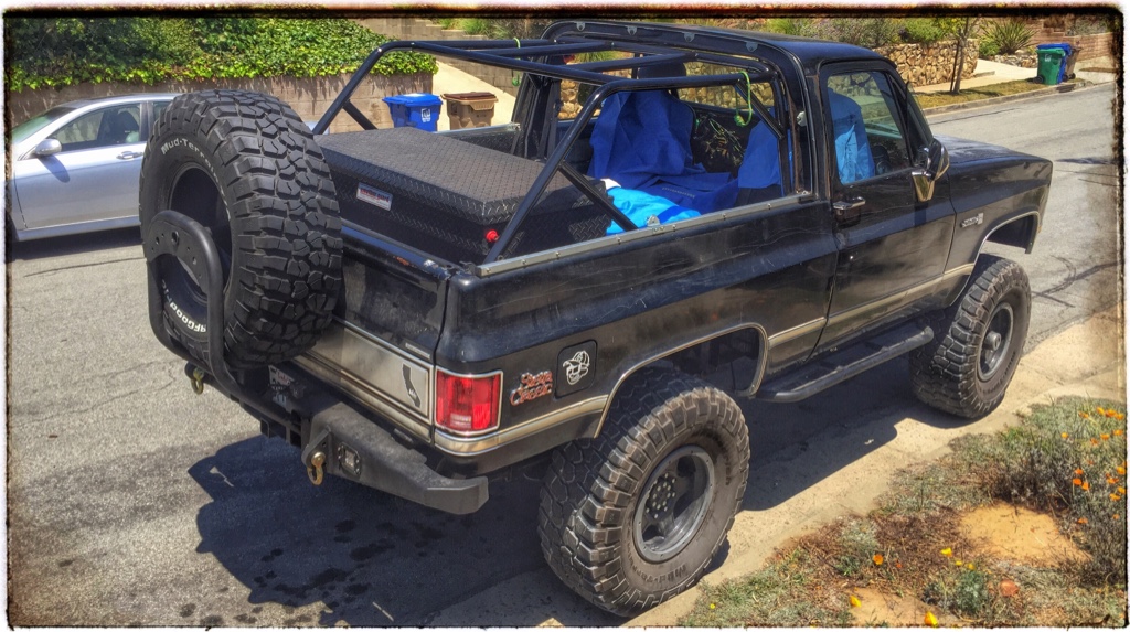

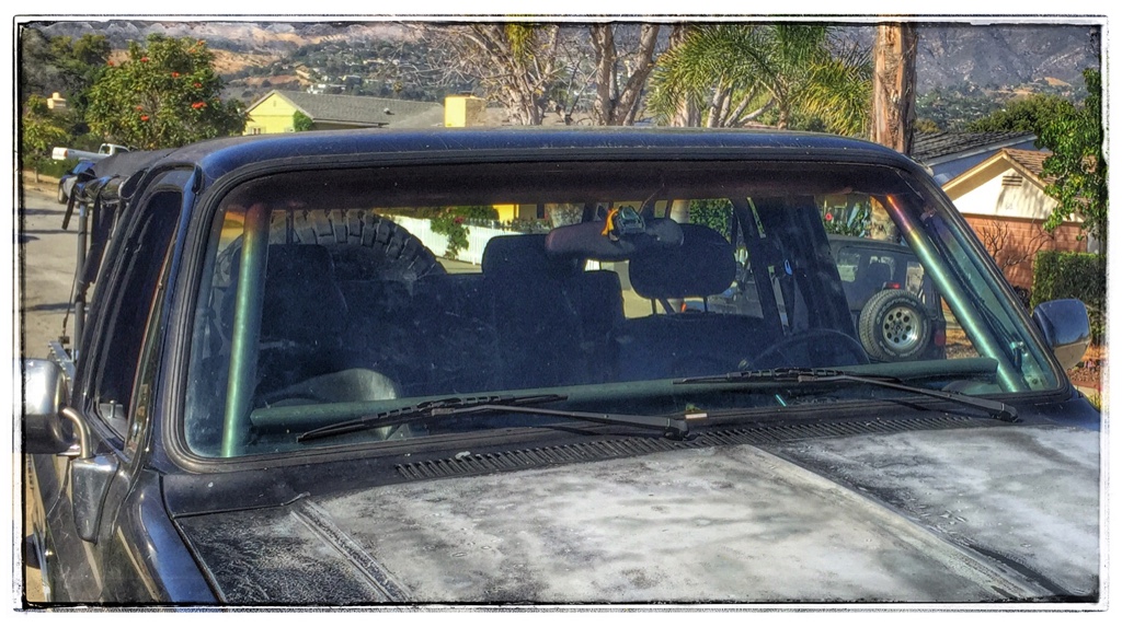

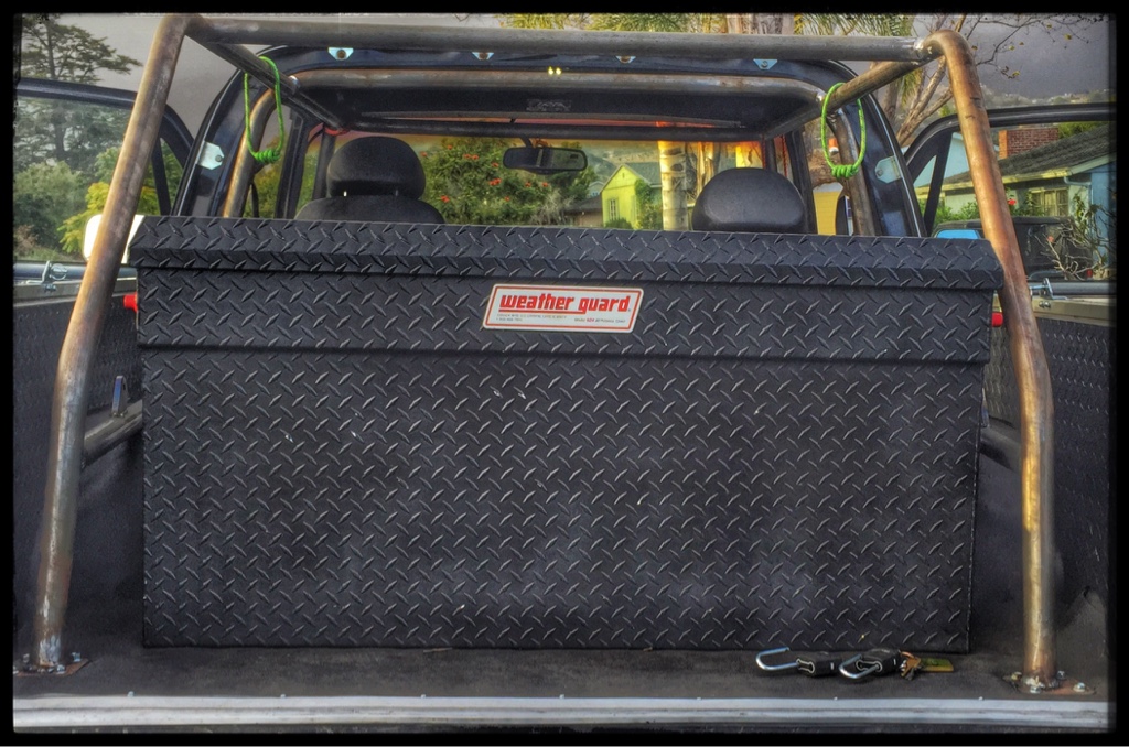

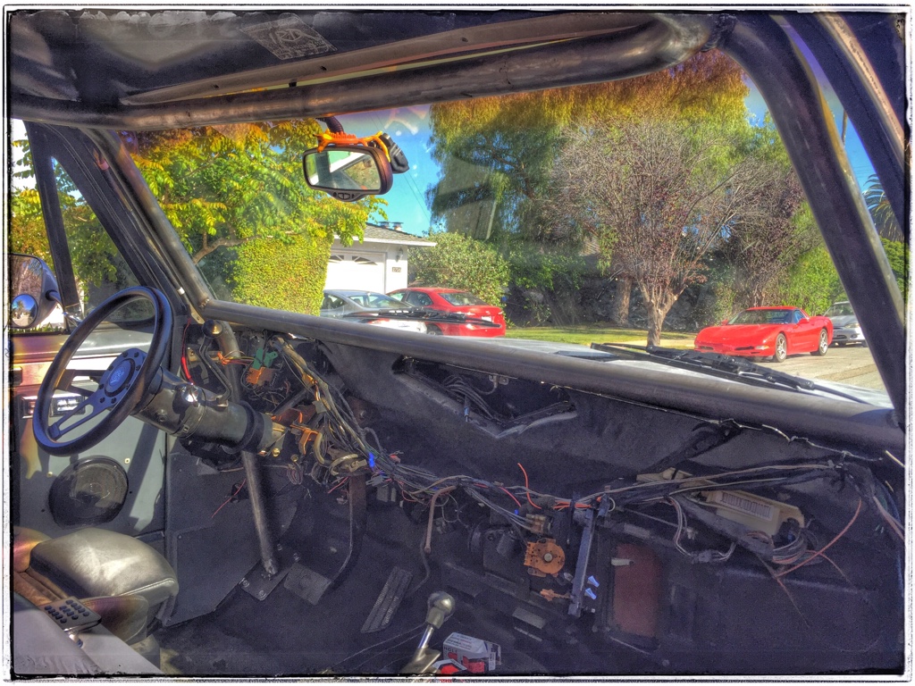

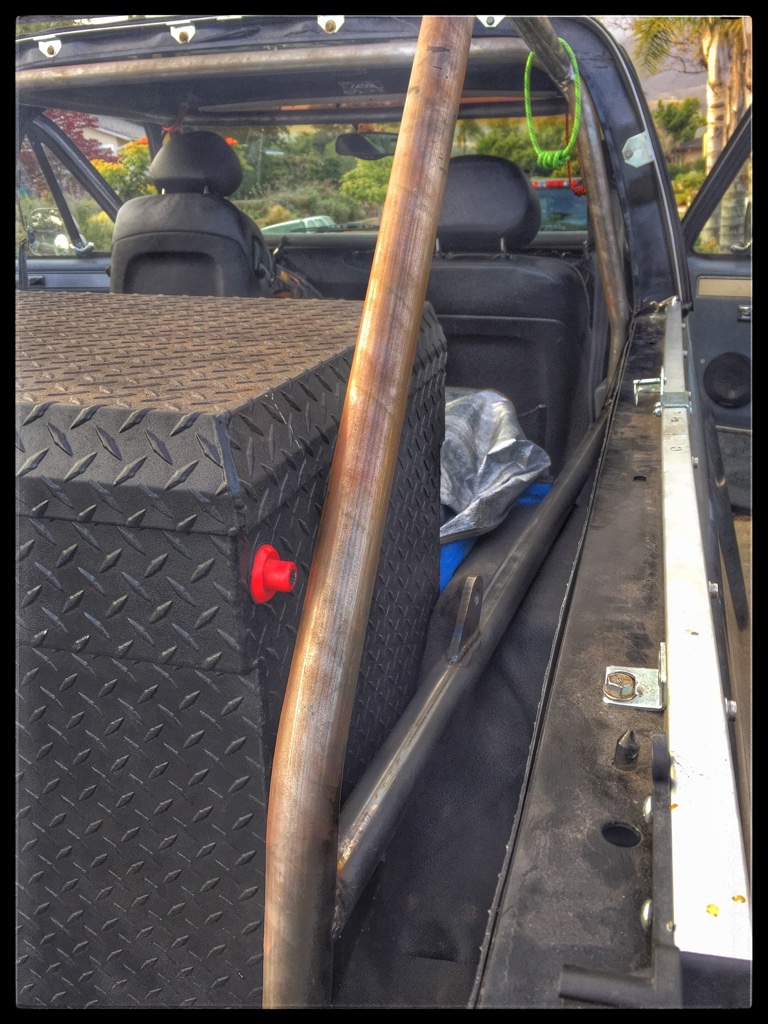

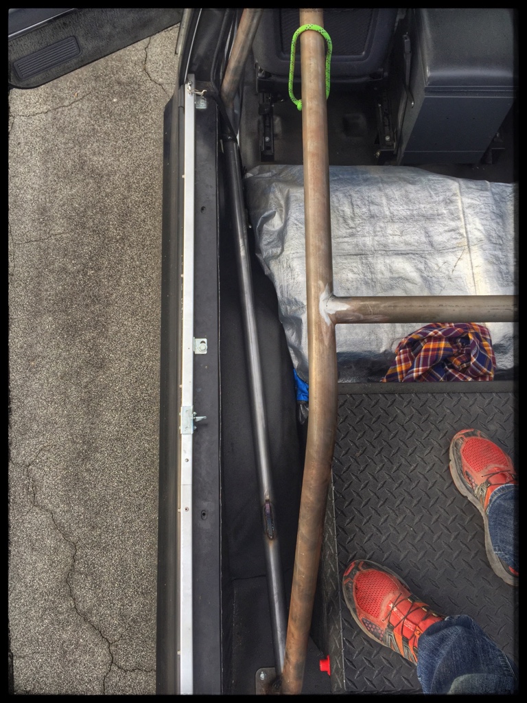

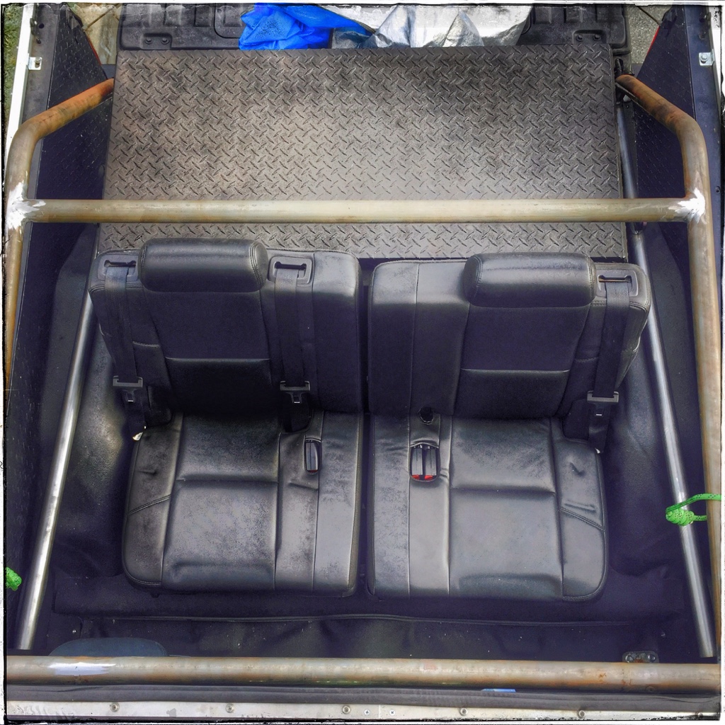

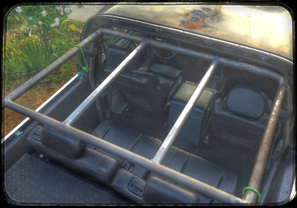

This is the first cage I have put in, and I just learned to weld last year. Here are some shots to give you an idea of the finished product.
