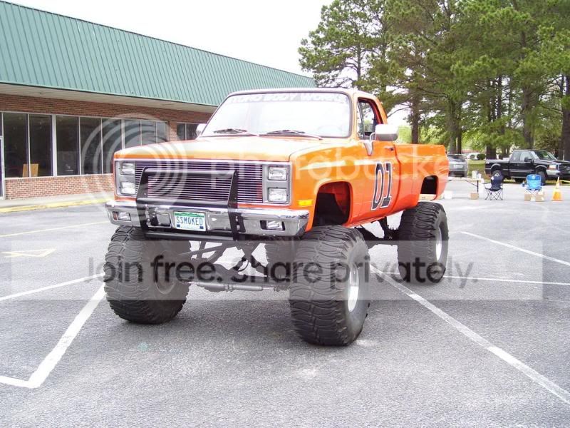

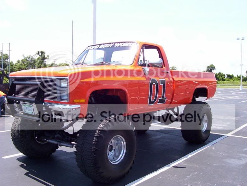

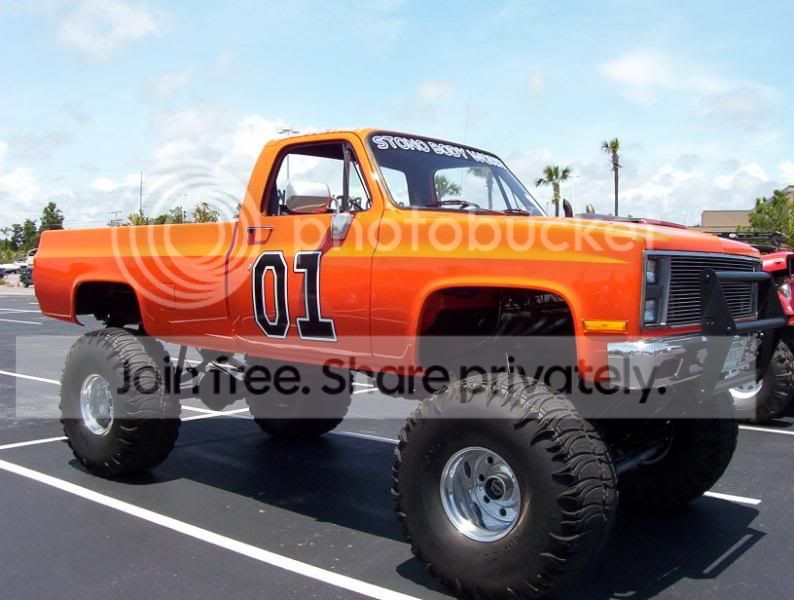

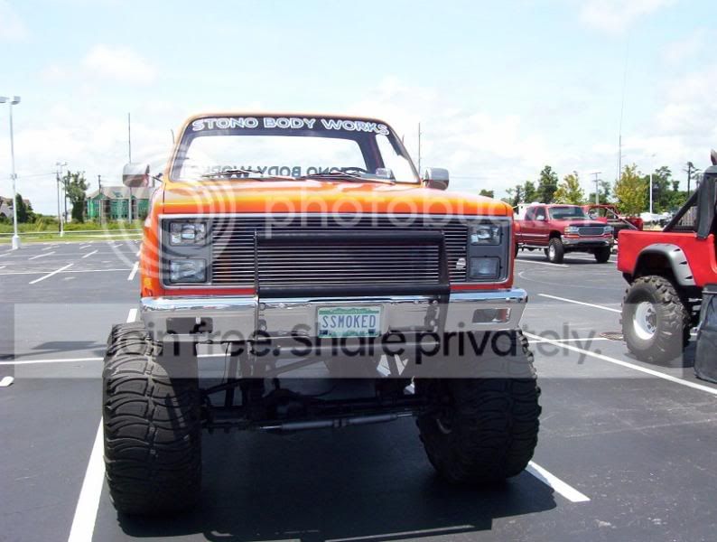

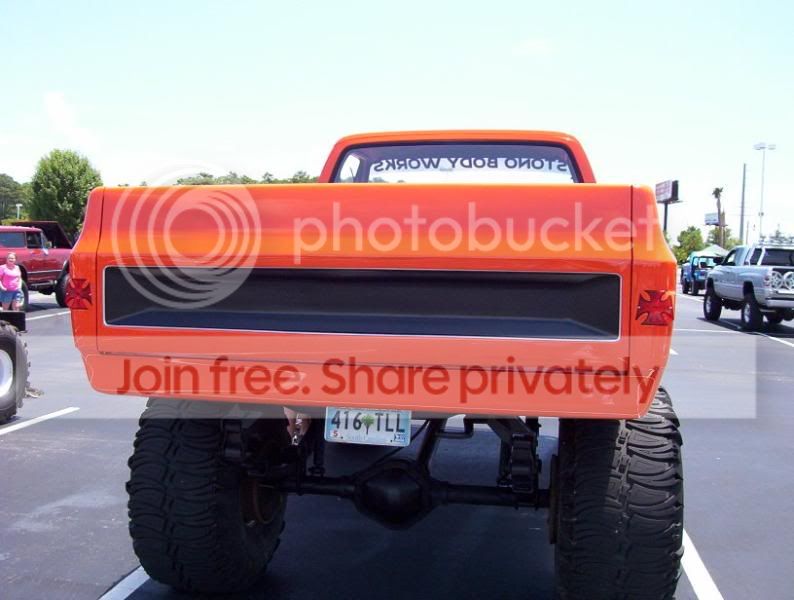

I grabbed these pics from another forum and absolutely love it...I've always wanted to give the Trxus STS's a try and after seeing this I think I will when it comes time for a new set...
Anyways I was just wondering if any of you had more info. on it...

Yeah I know the tires are good (for street 95% of the time and the occassional sand) but I was hoping someone had some info. on that truck...I can see it has a 14ff and X-over but thats about it drivetrain wise... I tried to look up the body shop's website (from the sticker on the windshield) but its down...
The bias ply's come in 39.5's or 44's and I don't want to make the 44 jump yet so I'll go with 6" springs and a 4" shackle flip out back...then 8" springs a zero rate and taller spring perches up front to fit the 39.5's...
Oh ok, I took what you were asking a wrong. Sorry, it's been a long night and I can't get out of here soon enough. Judging by the looks of the truck, he has a very similar setup as I do, if not dang near identical because those look like the 44's. I do see a shackle flip with no blocks and the axle looks centered so it's probable there is a zero rate in there. I noticed the crossover steering as well but couldn't make out the knuckles but looks like a D60. Good luck and be sure to post up some pics when you decide to do this. :D

It looks like a very well built rig though...no blocks all spring lift w/ a shackle flip, x-over steering, 14ff, etc...

Tires, shmires; though I gotta tell you the taillights turned me off.
