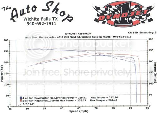

Why not go with a dyno proven muffler like a stainless Magnaflow?
Got this off another forum where they did a comparison same truck same day. 3" flowmaster SI/SO vs a Magnaflow 3" SI/SO
8HP and 6tq difference at the wheels, Magnaflow on top. Thats the only muffler I use in my racing junk these days. The longer the muffler, the more quiet it will be even though its straight through design. Same thing goes with the diameter of the body. Smaller the diameter, the louder it will be (in most cases). I did two long 3" magnaflows on my old 496 and without cats, it was still pretty loud.
