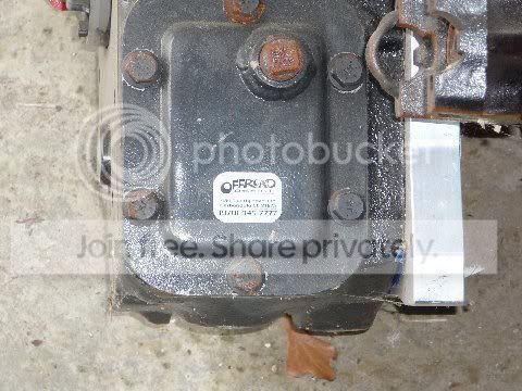

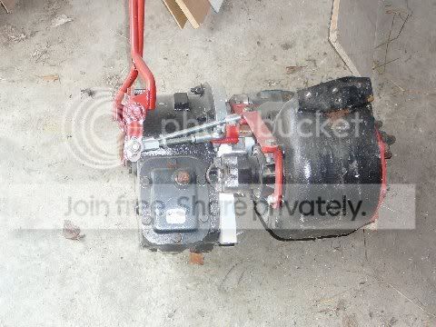

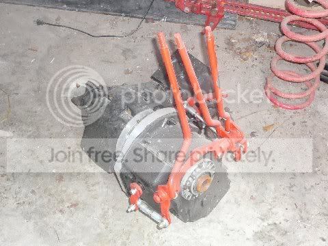

here are some pics of the setup...im only paid 1000 bucks for it so i figure even if i have to swap 203s its worth it...he was saying that you can drill nad tap the mounting surface on a dodge 203 also...does this help any??
sorry about the bad pics..

GM and Dodge 203's are the same pattern, the ford 203 is different.
