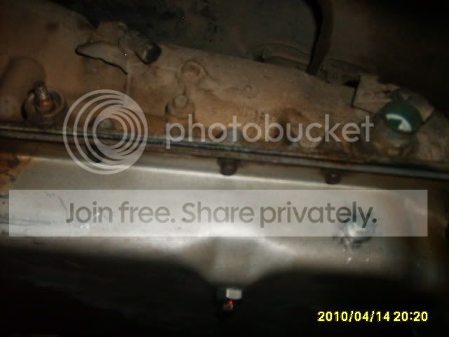

not true about the speed sensor, I just put a 4l80e in mine and it has two VSS, in the pic below the small connector in the front is the input speed sensor and the output speed sensor is just above the main harness connector. Everything I looked up and found shows both sensors in the same locations regardless of 2 wheel or 4X4, it's all befor the output shaft.
Speed sensor signal in an original GM 4x4 application is picked up at the transfer case. If you use the output speed sensor at the rear of the trans the computer will not be able to see the difference in ratio when you are in a lower range. As long as you are in two wheel high it will be smooth sailing.
yep I will believe that, I see what your saying now. The tranny does have both but to you need the one in the T-case when in 4X4 or your shift points will be off.
