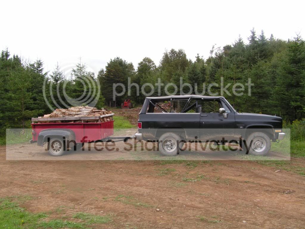

i never pulled the tape on the front chanels. had problems with my top last summer but gor it repaired at a upholsery shop. not many pictures 1st is old ,and second last fall. when it rains and driving slow my knee gets wet. ok at highway speeds.
