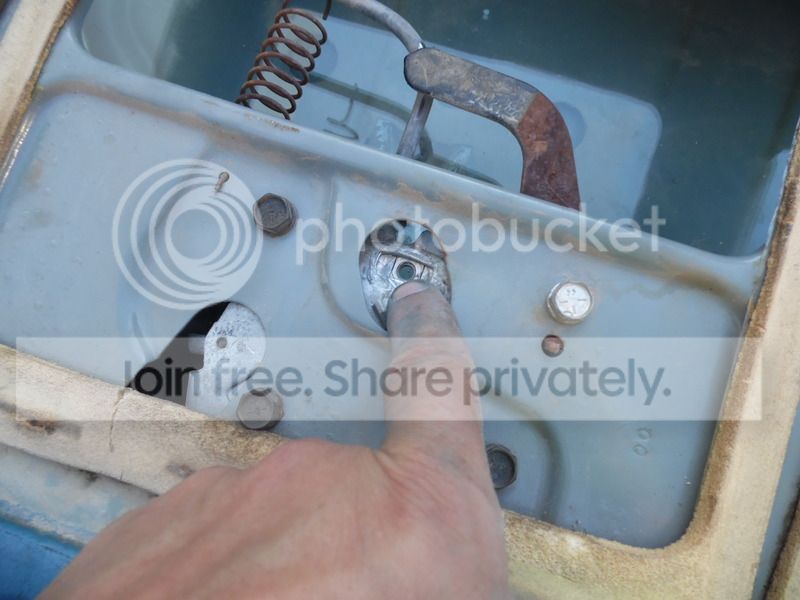

I figured out this screw for the tailgate latch was left hand thread. Right after I snapped the head off.
Anyone know where I can get one? I checked LMC, I didn't find it.
If its not a special shouldered bolt or something--McMaster-Carr probably has a left hand thread bolt selection..
I'd head for a salvage yard if your area still has any trucks of your vintage..
I already checked, looks like the wrecking yards here don't have it.
Yeah, I think its just a left hand 1/4 20. It does have a weird end on it, but I'm guessing that is just for ease of assembly. I'll get one from McMaster.
Thanks!

Just an update, NO hardware stores carry left hand thread anything. I could have ordered it from Fastenal though.
I got a cad plated one from McMaster. Tailgate is good as gold, I can unlatch it with one hand now. lol.
