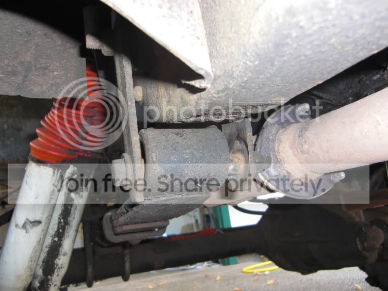

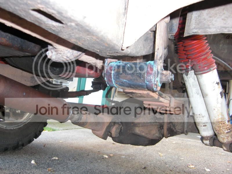

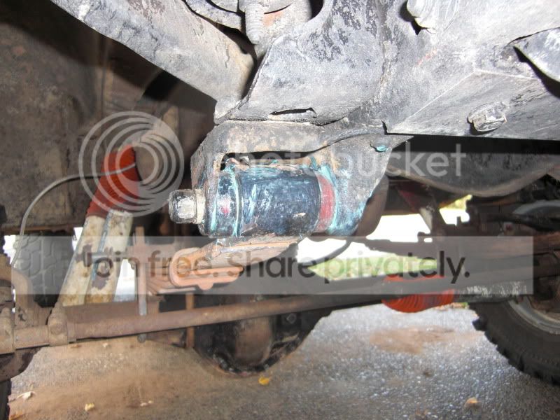

I took some pics to show how tore up mine were.

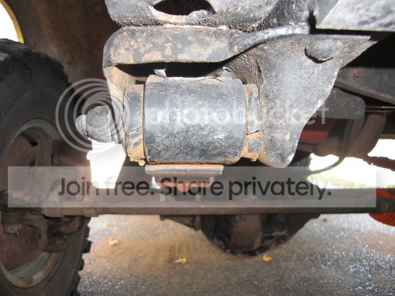

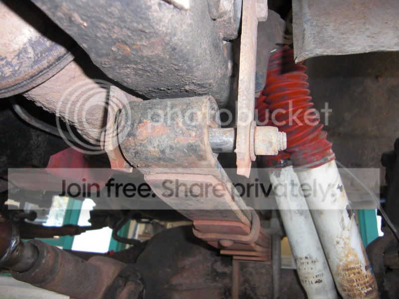

Driver side Rear
Driver side front
Passenger side rear
Passenger side front

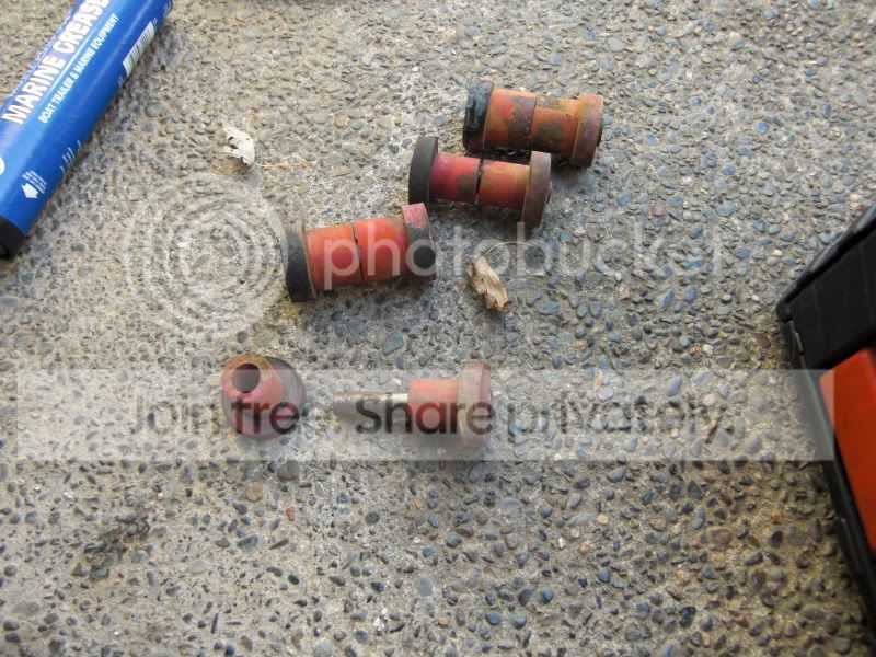

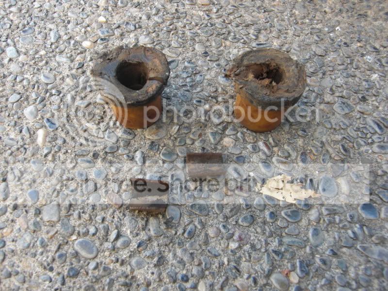

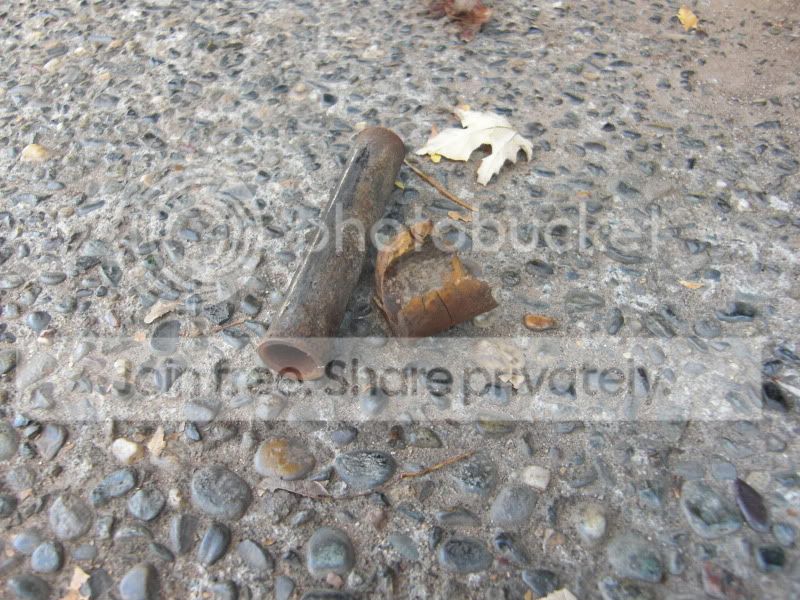

And here are some of the bushings (or what was left)

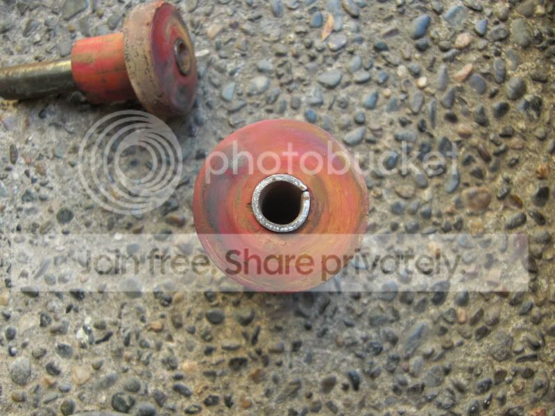

from rear
From front. Notice the inner sleave is somhow totally dominated.

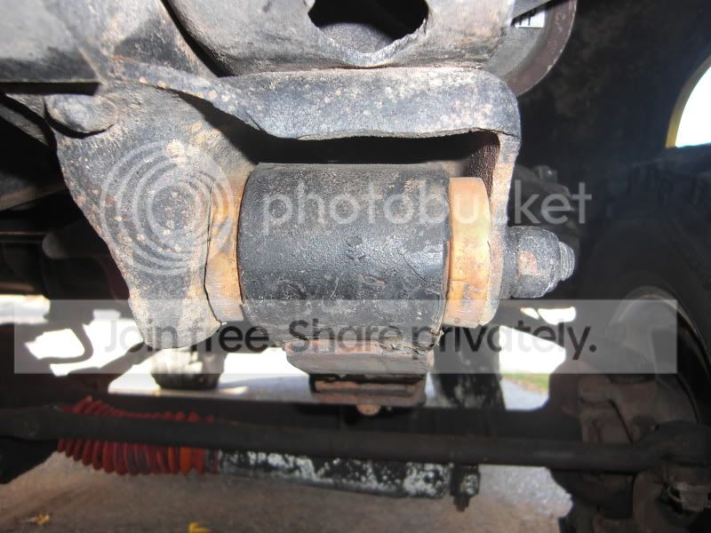

It didnt take too long to get them all changed out. I went crazy with the Marine grease. Put it everywere and very liberally. Here is the finished result.
I cant belive how bad they were and that i was driving on it!
Turns 300 times better.... doesnt sway all over the road like it used to and want to follow bumps. And no more noise while turning!
