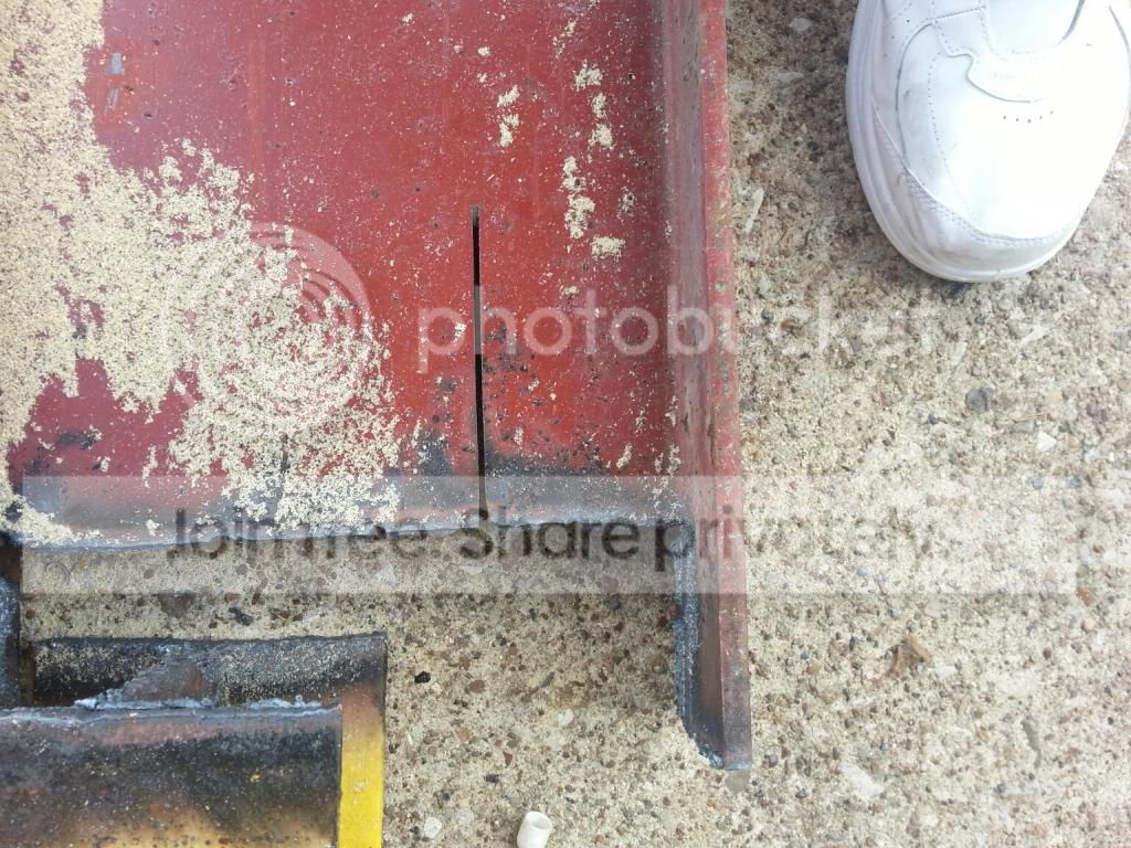

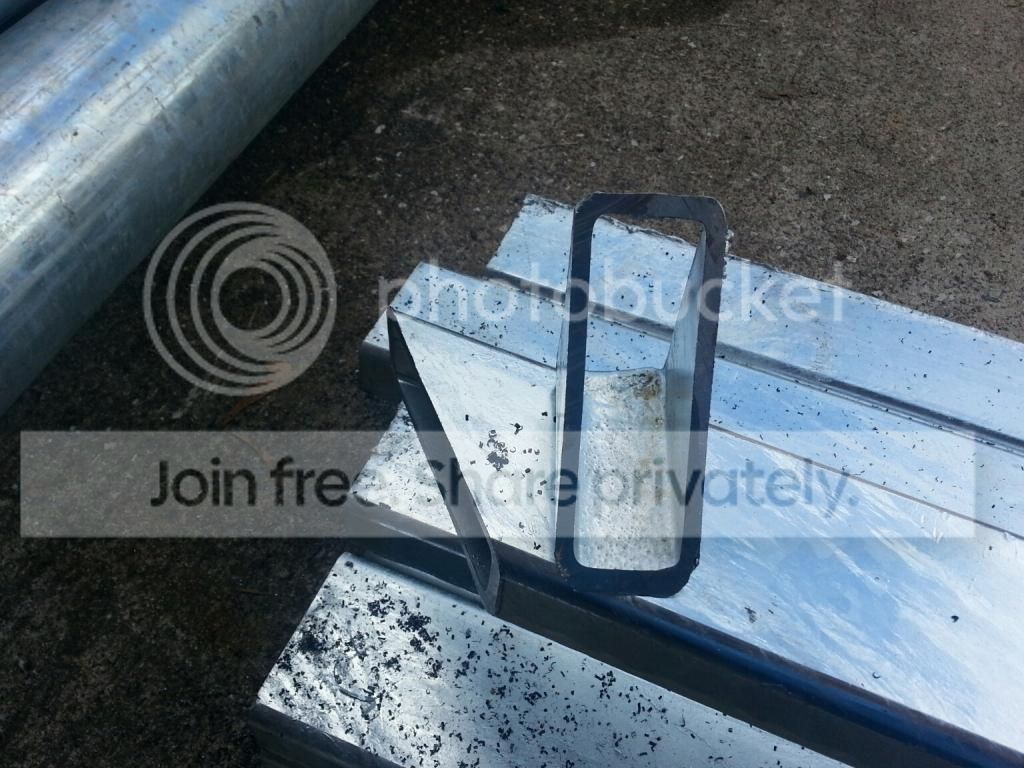

2 x 4 x 1/4" - cuts like butter...... no sparks...
I-beam test cut....
