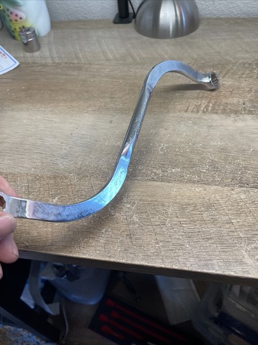

    there are special wrenchs for this. but i generally just use 1/4 drive stuff..
