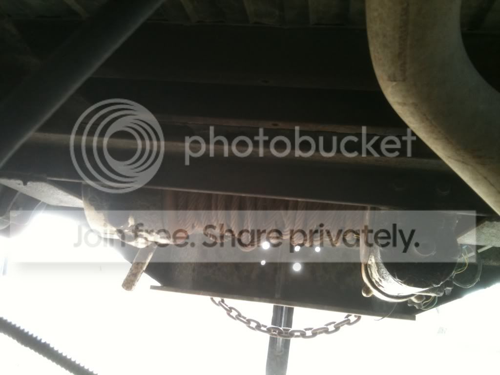

My winch is a shaft driven one.
Why would the doubler affect the PTO at all?
Leave the 203 gear box in hi, shift the 205 however you normally would. The 205 doesn't care what's in front of it, just how much torque it receives, and in hi range it would work just like a 205 in a stock application.
That looks like my old winch. It was shaft driven.
I've still got it, but when I went to put it on the new truck and realized that I was going to have to go hydraulic, I bought a new one with the motor already mounted.
The old one had been on two trucks and a Jeep already and had done lots of very hard pulling, so I replaced it pending a rebuild.
Mine's a Braden, shift handle looks like yours.
But what the heck are the wires on there for? Electric brake?
