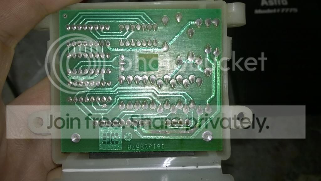

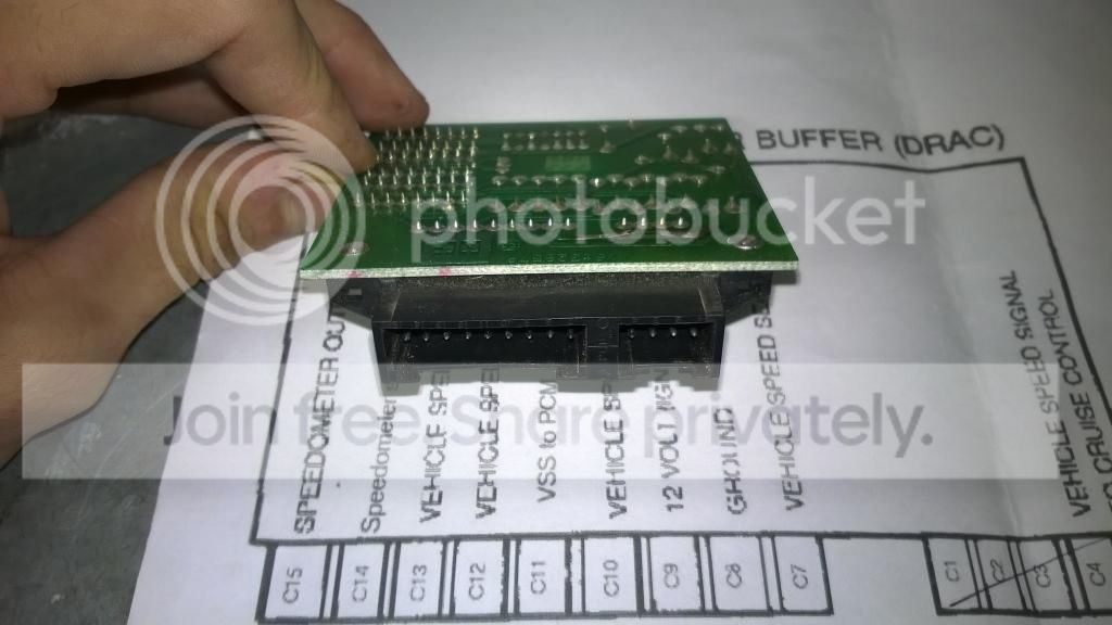

So in attempt to fix it we bought another speedometer, still doesnt work. Then we read up on the drac and figured that ours could be junk. So i got 2 from a salvage yard for $20 and it still didnt work. I then traced the wires going to the drac and for some reason the ground went to a port on the old obd for the truck. So i grounded that to a metal bar in the dash so that i got voltage from terminals c9 and c8. Also noticed that i was only getting continuity from the purple wire that goes to the vss, not the green one. So i traced that back and connected those. As far as the two wires that go to the pcm, (c13,c11) i dont know what to do with those because the truck no longer has the truck pcm, its been swapped to the transam pcm. Do i need the pcm for the drac to work, i have read on certain sites that i did and other sites that i do.
After i made sure that the vss was connected and it was getting power i tested out. Once the truck started i heard a pop. It was the drac.
I measured the voltage from the plug and it was getting 13.6. Is this too high?

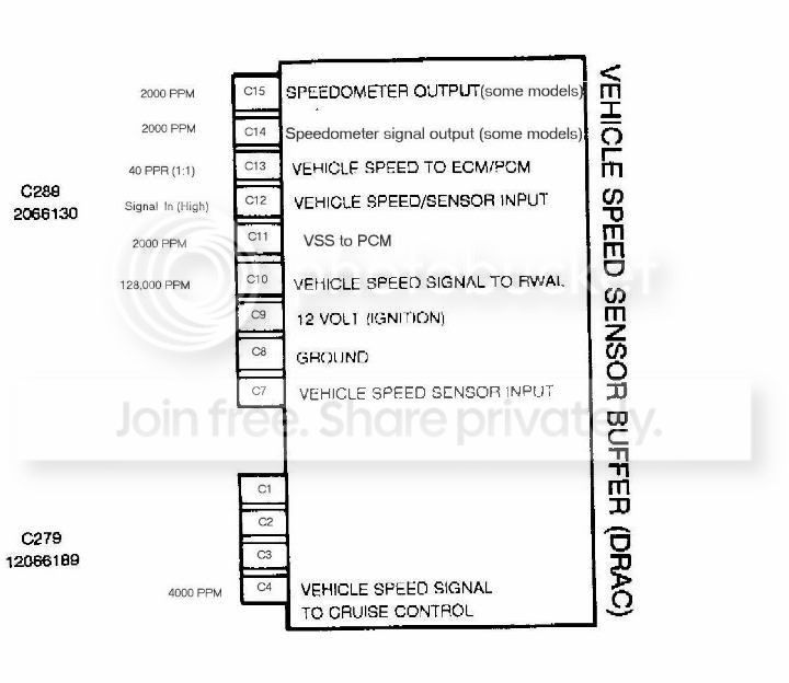

Heres the pinout ive been using.
