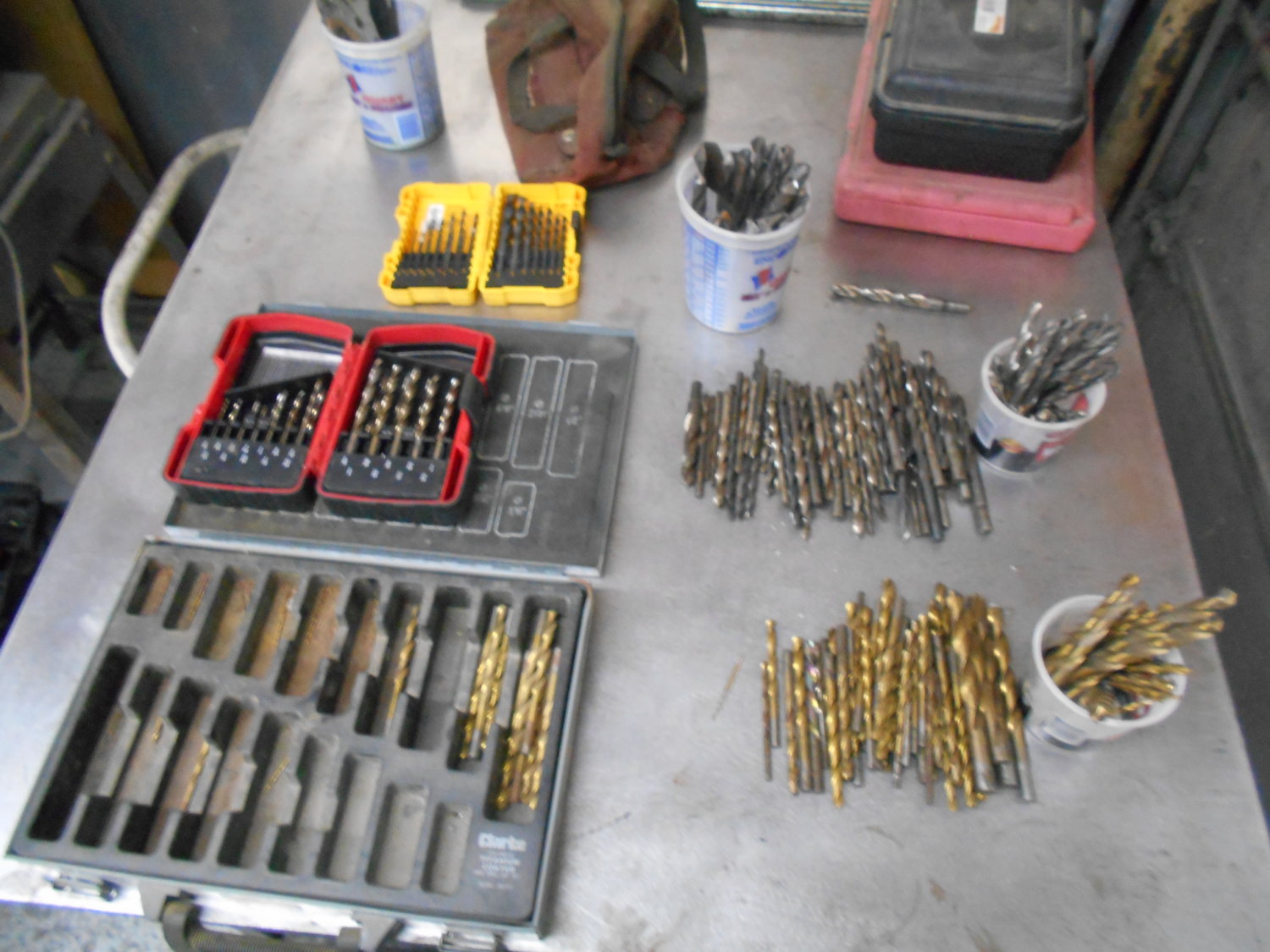

full
the lower case and gold bits are really junk.. very sacrificial even when new.. I've actually bent them, lol... but I hung on to the case to possibly use down the road... the middle black pile are all quality bits up to 1/2.. MOST being duller than a crocheting contest....
the container at the top are all bits above 1/2".. i sharpen those by hand as needed... the yellow is a new dewalt kit i like to keep around for work.. the red are lifetime warranty ones from Mac I use at the house here... I do need to warranty a couple broke ones and a couple dull ones.... but i have no mac guy anymore, so i need to figure that out..
anyway, who has/uses a Drill Doctor? do they work good? I see a whole bunch of different ones listed at various places... I'd like to bring that pile of good black bits back up to snuff and do better maintenance down the road...
still trying to figure out what I want to do for storage.... don't want to use a standard metal index box... I'd love a cab with drawers and individual compartments.. but can't justify a bunch of money for it either.. Drill Doc would be an extravagant buy to begin with... currently they are all piled in the small tool bag at the top..

i did... didn't get the Doc yet, but i did some organizing at least with new containers that I repurposed.. .. i'll post pics when i get a chance.. i've been using those paint buckets at work on my tool "shelf" in our shop for yrs now :haha:... we don't have room for my Snappy box down there... i've been eyeing various "containers" on the web... for all kinds of stuff... just bought one of those dewalt "small parts" boxes... using it for misc driver bits... gonna get another as a small elec connector box.. they're cheap, like $6..
i'd sell redheaded stepchildren to find a source for the small, yellow Dewalt drill bit boxes pictured above with the slide-lock... I have about a 1/2 dozen old ones that i rip the indexes out of, and store various things in each.. countersinks, carbide burrs, feeler gauges, driver bits, etc.. can't have enough of em, just sharpie em... I'm ready to go buy a 1/2 dozen $10 bit kits, JUST for the boxes! ;)

yeah, i've eyeballed the nice metal drawered "bit boxes" for the shop... that sounds like a good idea on the cheap... my big thing is, being marine, I work out of about a dozen various tool bags.. plier, screwdriver, 3/8, yada... i also have one bag that is strictly to carry around those small bit boxes that i repurpose..
