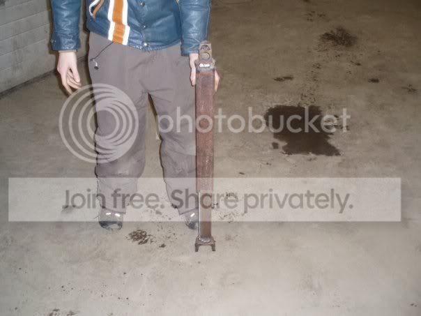

My buddy left for work but we found that he had bought a ball joint removal tool from harbor freight essentially a c-clamp on steroids :D
One question though, should I use the yoke on the drive shaft side of the CV, I already cut out the center section. I'm just wondering about strength now I suppose i could beef it up but do i need to?

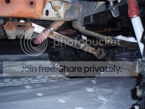

well here are the results, testing it out tomorrow. :wink1:

I'll grind another notch and set it right, someone told me that it should be out of phase... he drove a ford :D
Drive shaft works great though, only vibrates when i have the hubs locked in while in 2wheel or clutch in while in 4wheel.
The cross pip for the exhaust was in the way after dropping the T-case and I was broke so I band-aided it for the time being.
