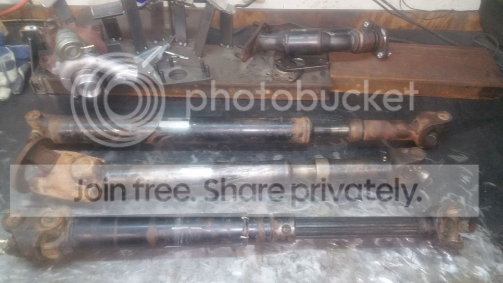

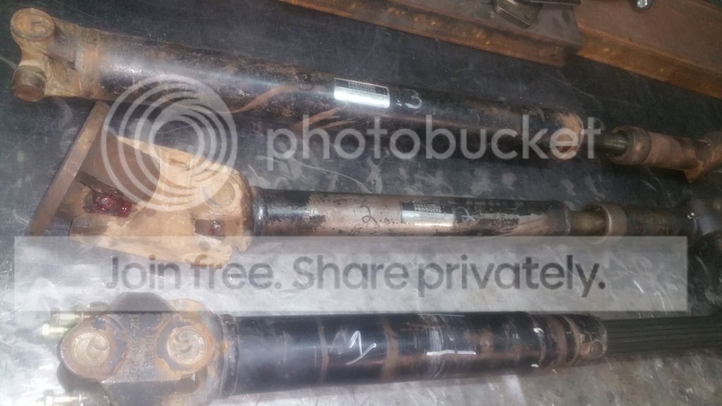

hey guys, got my 203/205 doubler in and trans tunnel done. so now im on to drive shafts before i fab my crossmember. I want to make sure the crossmember doesn't hit the shafts , i'm trying to do something kinda temporary untill i can afford some real shafts. I bought the ord companion flange for my 205 and don't know what yoke will fit on it from my drive shaft. i'm trying to see what i can do with these three shafts to make something work. #3 is the rear (to long) i want to double cardon it. #2 is the front (way to short) #1 is one a friend gave me. I'm hoping i can cut weld whatever combo is best and get them balanced. then later on get a high angle driveline or something.

Companion flange is from ORD and its for the rear of the 205 so i can run a double cardon. Im at work and dont have any pics but i can take some when i get home. The stock 12 bolt still has the 1310 yoke. I would like to change all of it to 1350. All the yokes and u joints are 1310. I can keep the 1310's if they are not going to explode instantly. Then i would just need to shorten the rear and lengthen the front and figure out the double cardon situation on the rear. If i do 1350 all around i dont know what and where to order. Im thinkin 2" .120 wall dom. Thank you.
