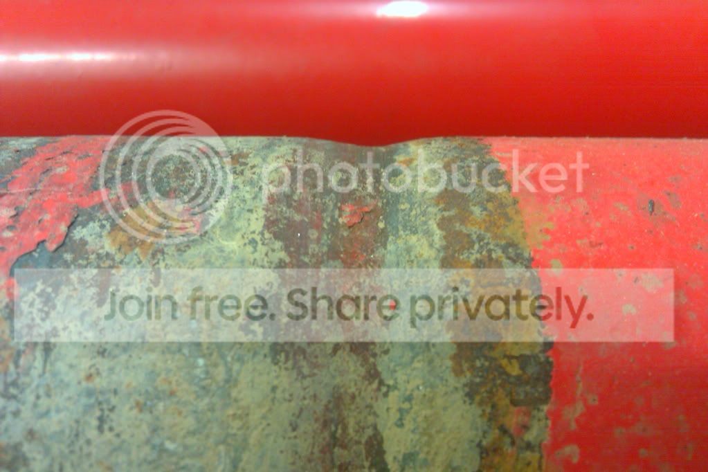

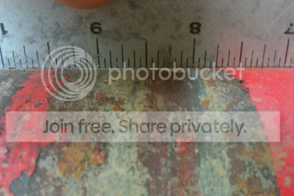

The driveline that I have now is messed up. It vibrates, Got jacked from when I was stuck on that minivan. I want to get one built, And use this one as a spare.
Pics of mine now.
Here is the grooved out driveline. This is why I need a new driveline.

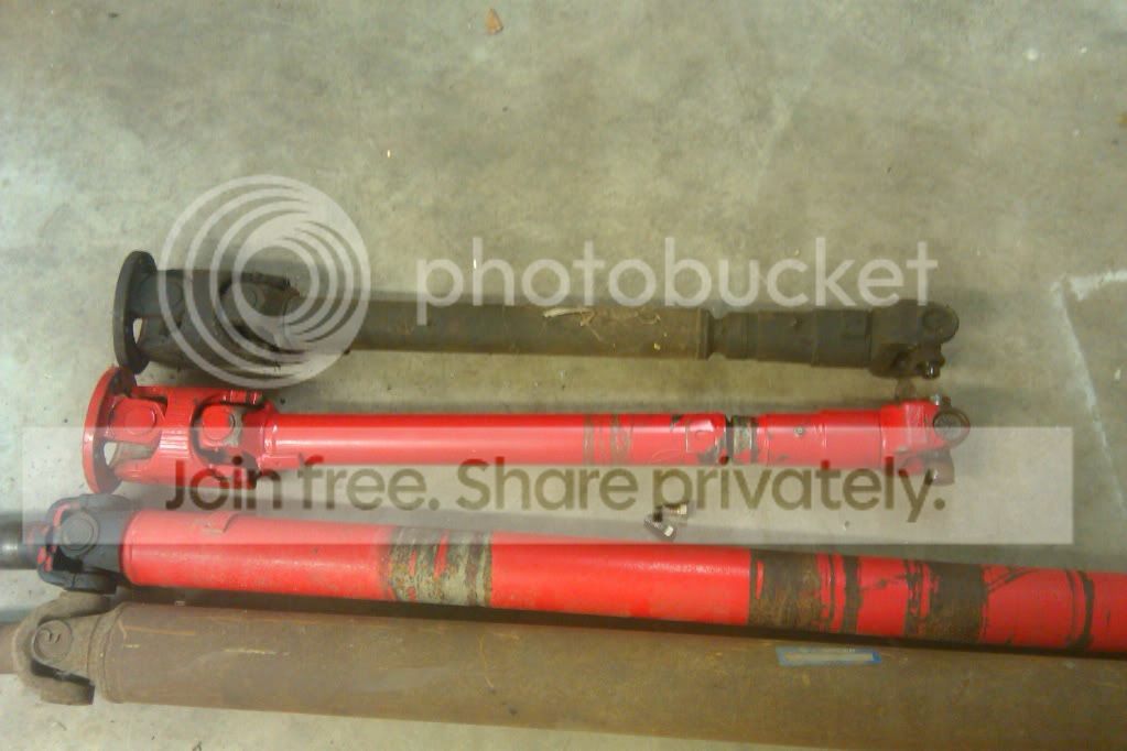

What size ujoints do you need? I have some 3/4 ton drivelines with 1350 joints and a slip yoke for the NP208.
I dont know. I do have a 14 bolt though! Sounds like it might work! Is the 14 bolt 1350? If so. Thats what I need!!!
In the picture, The red driveline is my 1/2 ton. Next to it is a 3/4 ton driveshaft. But, it has a TH400 slip yoke. I am pretty sure it won't work with the 208.
It should work if it has the correct spline count... I'd at least try it before you buy anything else.
Crap, it fits! I have had a few beers, but it slipped right In. I need to get a closer inspection, but It worked. I don't know why I didnt try it first. Most of my drivetrain is sitting on the garage floor.
