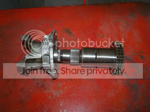

Gotta 82 k5 replacing tired th350 trans and 208 with a newer 86 k5 th350 and 208. Now i find that the yoke (part that attaches the shaft to the transfer case, guess thats what the hell its called)from my old one will not fit.Anybody got any idea of where i can get one?
Found this pic on the board si i jacked it. It looks like this one
bigblue82 said:
So if your front driveshaft is the issue, that is called a flange.
It's flat and has our bolts that go through it.
You need a CV driveshaft with a flange instead of a yoke which you had before.:D
I have some but i need a length to match.
Plus shipping.
Maybe better to find one local.
can't he just pull the yoke off and then bolt on a flange, if it's the same spline? i thought all newer stuff had the flanges?
try denny's driveshafts under google. they have everything and then some. plus there nice and helpful!
If he still has the old case that would be the easiest and cheapest.
I am guessing he probably already gotten rid of it.
