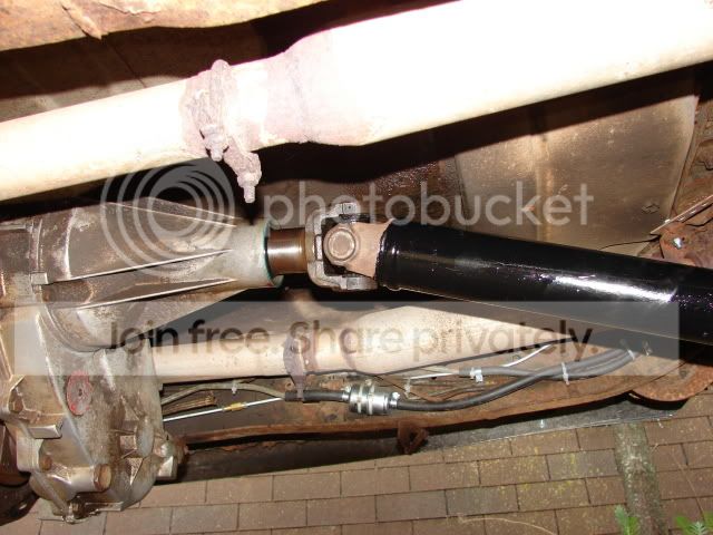

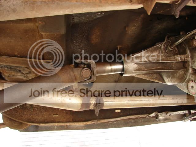

I had to lengthen my rear drive shaft 2 inches.
Before:
After:
