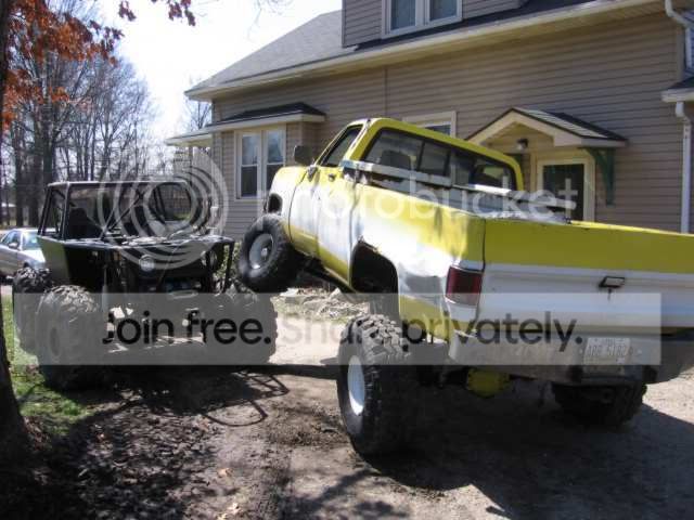

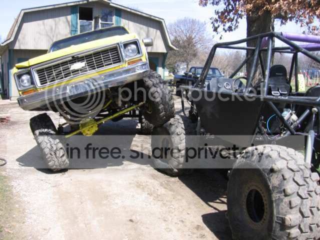

Mike stopped by with big yellow...here's some pics..
