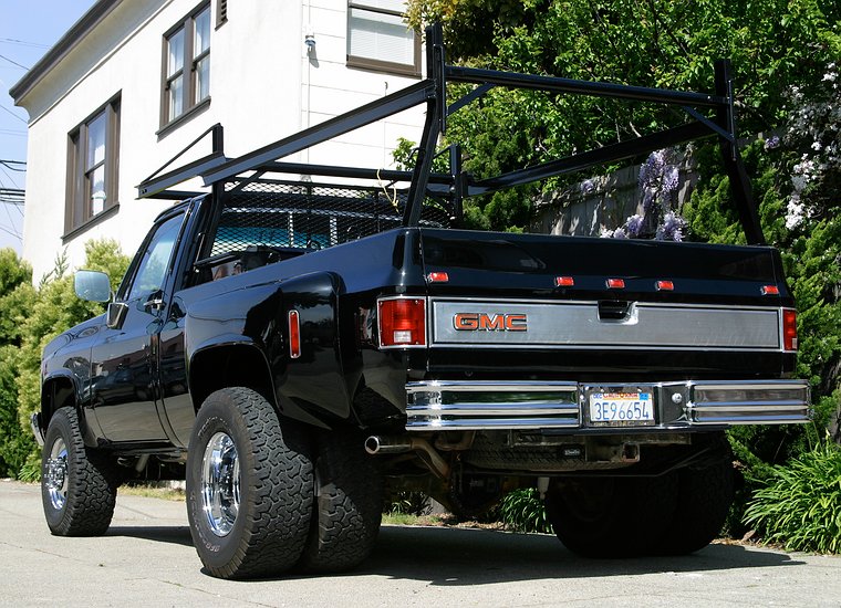

I'm looking for some info and can't search(for now), maybe someone will remember what i saw awhile back, i saw a dually rear end, w/ both tires tucked inside of a regular fleet side bed or a k5 tub, I'm sure the pu bed or k5 tub would need to be tubbed out like a pro-street car.
we are curious as to how they are making the dually rear end so narrow?:dunno:
I'm try'n to find this info for a friend, who said thats what he wanted, and wished gm would have made it! i told him i had seen it, and i would try to find out how its done, so I'm curious now?
also how much trouble is there w/clearance from the inside of tire to frame?, i assume the spring packs have to be in boarded. a link to build thread for said truck would be awesome, or just the info on how its done, would be appreciated. thanks for your time.

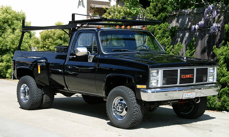

hmmmm...interesting ..very technical, not sure i understand it all, any pics of this truck sittin on its tires? how much tire is it running? also, i noticed his spings weren't inboarded, i wonder if you did inboard the springs & tubbed the floor more, if you could fit the 38.5x11 boggers side by side in the rear
I know there is a better pic around here somewhere, it has changed a bit since that pic was taken. I do know that he mentioned that it was a C before, so it already had the narrow spring spacing to work with this setup.
I know that Kert at DIY4x was doing some pretty trick stuff with inboarding and using a C&C axle, but that isn't quite the same as Dremu's setup.
If you were to do this with a K5, you would have to do something pretty drastic as far as a rear seat, since 6-8" narrower means losing a seating position.
I also don't think you could put anything quite that wide on a side by side setup, but I could be wrong. The issue would be that the frame isn't going to give enough clearance to fit.
Here are a couple of pictures, and my apologies to dremu for stealing them so I could post them for you.
Hope they help with picturing the setup.

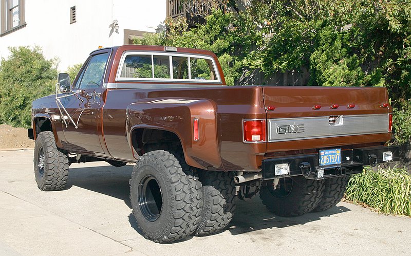

Wider dual tires
Has anyone tried to do the same setup with wider wheels and tire's,,,lets say 16.5x9.75 wheel and 12.5 tire???? That's what I'd like to do on mine...........................

First up, thanks guys for the good words.
It is not, in fact, a C&C axle ... read the (admittedly long) description in the linked page. I couldn't have said it better myself (wait... :D ) The truck is still 2WD, but is a C30, i.e. one-ton, and that's where the narrow spring spacing comes from.
There are two issues with wider tires for duallies. The obvious one is tire clearance on the inside, so you either gotta inboard your springs and tub your wheel wells, or scoot the WMS out some.
The other is that you need deeper wheels or wheel spacers, so that the tires don't rub against each other (the other kind of tire rub =))
Check out any posts by "Eric M." here ... the guy is a dually NUT and has some sweet trucks...
IIRC he has custom wheels and all kinds of crazy stuff to make those work ... but they are purdy :deal:

Eh? 'Sall good. There's no reason to apologize ... that's *why* I take so many pix and post 'em up here, is to show others what I've done, share info, etc. (Well, that and I'm a pic whore =)) You note I'm linking to Eric's pix, but I'm sure he won't mind. He's proud of his duallies -- and for good reason. (The big tire thing isn't my bag for duallies, actually, but his trucks are clean regardless.)

Brown Dually!!!!!!
That truck is AWSOME!!!! Thats exactly what I want to do to mine.....!!:bow::bow: Where can I gat more info on what wheels and spacers he used?????????:eek1::eek1::bow::D
